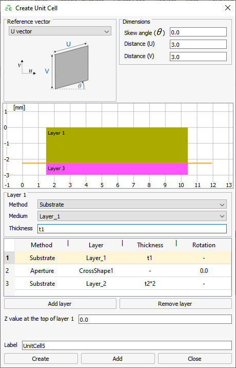

Defining a Unit Cell
Define a layered unit cell using layers of substrate, free space and metal.
On the Periodic Structures tab, in the
Structure group, select
Unit Cell.
Figure 1. The Create Unit Cell dialog. -
From the Reference Vector
drop-down list, select one of the following:
- To specify the skew angle relative to the U axis, select U vector.
- To specify the skew angle relative to the V axis, select V vector.
Under Dimensions, specify dimensions and orientation of
the unit cell:
In the Skew angle (
) field, specify the unit cell skew
angle.
Tip: A skew angle of 0 degrees yields a rectangular unit cell.
- In the Distance (U) field, specify the unit cell dimension in the U axis direction.
- In the Distance (V) field, specify the unit cell dimension in the V axis direction.
In the Skew angle (
angle.
For each layer:
From the Method
- To specify a layer of substrate (dielectric) or vacuum (Free space), select Substrate.
- To specify a layer of metal, select Metal or Aperture.
Tip: A Metal layer realises the shape exactly. An Aperture layer realises a metallic layer minus the shape. -
For a layer of substrate, specify the following:
- In the Medium field, specify the dielectric medium or Free space for vacuum.
- In the Thickness field, specify the thickness of the layer.
For a layer of metal (Metal or
Aperture), specify the following:
- In the Shape field, specify the shape to be used.
- In the Rotation field, specify the rotation of the shape.
- [Optional] To specify a thickness, select the Define
thickness check box and in the
Thickness field specify the metal
thickness.Tip: Specifying thickness creates a 3D layer of metal.
From the Method
- In the Z-value at the top of layer 1 field, specify the Z axis position of the top of layer 1.
- Click OK to define the unit cell and to close the dialog.
