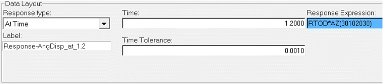

At Time
Captures the value of a given solver expression at a given time.
Figure 1. Response Type – At Time
| Input | Description |
| Response Expression | The solver expression that is to be computed. |
| Time | The time point at which computation is desired. |
| Time Tolerance | A small time interval around the desired Time required for computation. |
In the above example, the response variable captures the value of the expression that measures rotation of a marker at time value of 1.2.
