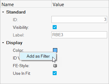

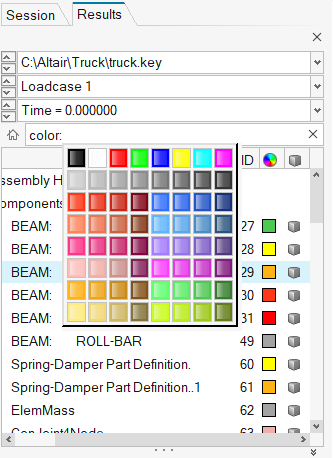

Use Add as Filter to Define Search Parameters
The filter is added to the search field in the browser. If you add more than one filter type, it will be added to the search field, with the word AND.

The Results Browser contains several ways to filter results data to display specific entities in the browser.
