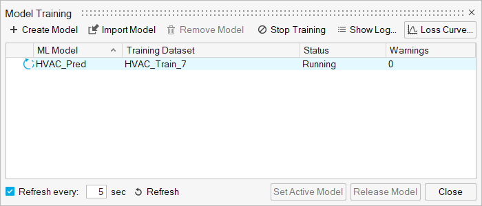

The Model Training dialog
opens.
Review the status in the Status column.
Tip: Once the status changes to Running, you can view the training
logs by clicking Show Log.
Figure 3.
Optional: Click Loss Curve to view the training of a validation
loss curve.
