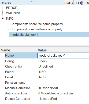

Create New Tcl Checks
Create new Tcl checks in the Model Checker.

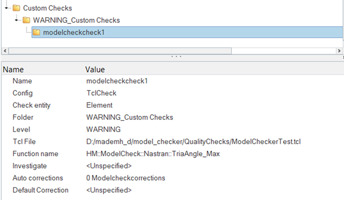

Key Points
- The check name should be unique.
- Config should be set to “TclCheck.”
- Entity type should match the type of entity on which check is performed.
- A level should be associated with check.
- Function name should include the entire name of the Tcl procedure with namespace.
- The Tcl file name can either be a relative
path from the checks configuration file or the absolute path of the Tcl file containing the Tcl procedure.

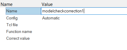

Create Corrections

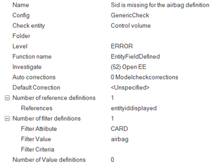

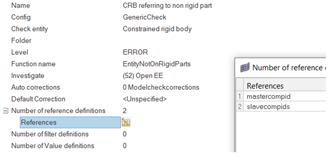

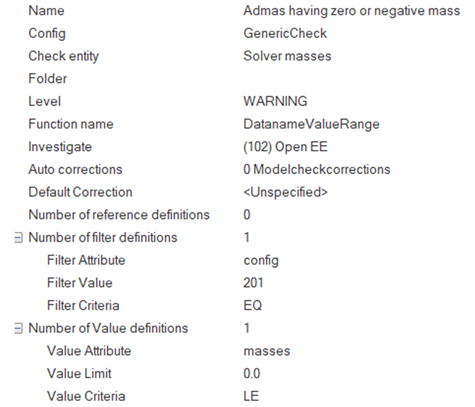

Some pre-defined checks are available in the Model Checker that can be easily customized. The config of these checks is “GenericCheck.”
Overview
- Use a unique check name
- The entity type should be set to the type of entity on which the check is to be performed
- A level should be associated with the check
- Function names that can be customized are listed below
- Define filter definitions, value definitions, and references as applicable

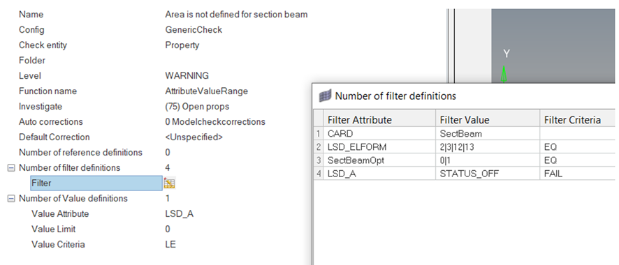

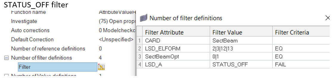

- Filter definitions:
- Filter Attribute – “CARD”, “CONFIG”, “TYPE”, “GROUPTYPE” or name of attribute as defined in template
- Filter Value – Filter to pass (attribute name or value). Even status of the attribute can be checked in some of the above functions using “STATUS_OFF”
- Filter Criteria – PASS, FAIL, EQ, NE, LT, LE, GT, GE. PASS and FAIL
usually used for STATUS_OFF filter
Figure 4.

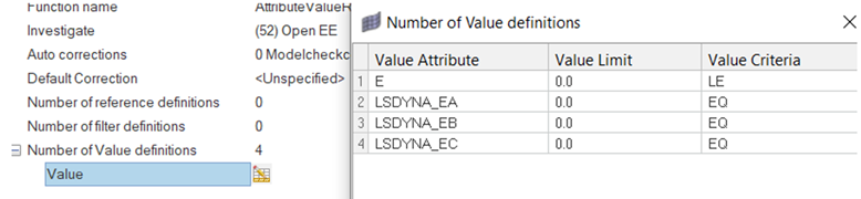

- Value definitions:
- Value Attribute – Dataname or attribute name as defined in template as applicable to the functions above
- Value Limit – The acceptable value limits
- Value Criteria – EQ, NE, LT, LE, GT, GE

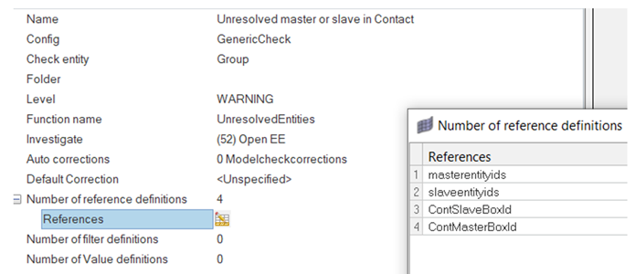

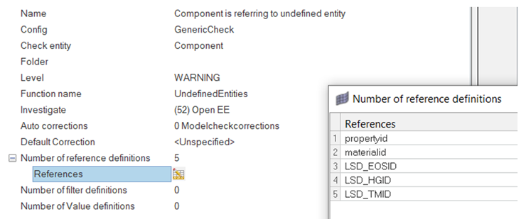

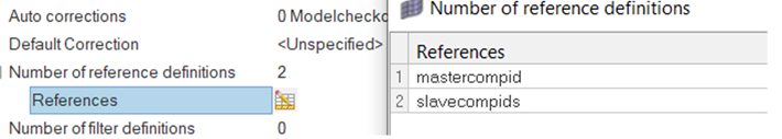

- Reference definitions:
- References – Dataname or attribute name as defined in template
Figure 6.

Figure 7. Area is not defined for section beam
Figure 8. Admas having zero or negative mass
Figure 9. Sid is missing for the airbag definition
Figure 10. Component is referring to undefined entity
Figure 11. Unresolved main or secondary in contact

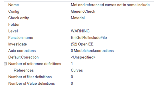

Figure 12. Mat and referenced curves not in same include

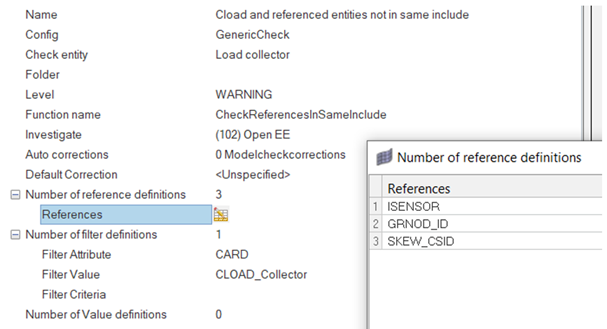

Figure 13. Cload and referenced entities not in same include
Figure 14. CRB referring to non-rigid part
After checks are added, right-click in Model Checker Browser and click Save config file to write out the checks to an .xml config file that can be accessed later.
