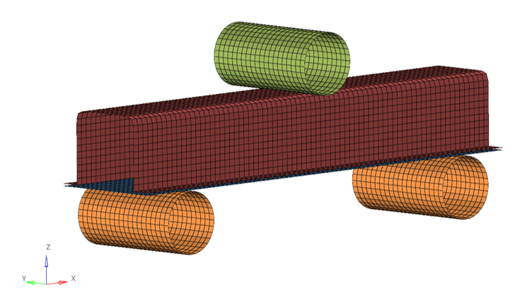

This tutorial demonstrates how to set up a 3-point bending model consisting of a head profile and a closing plate.

Model Description
- Material creation (with strain curve creation) and assignment:
- Elasto-plastic material /MAT/LAW36 (plastic):
- [Rho_I] Initial density = 7.85e-09 (ton/mm3)
- [nu] Poisson’s ratio = 0.29
- [E] Young’s modulus = 210000 (MPa)
- UNITS: Length (mm), Time (s), Mass (t)
- Simulation time: [0 – 7.01E-02]
- Boundary Conditions: The supports are all fixed. An imposed velocity of 1000.0 mm/s is applied on the impactor.
- Model size: 370mm x 46.5mm x 159mm
