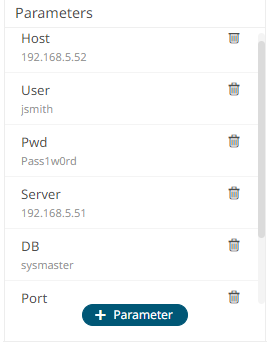

1. On the Parameters pane of the Data Table Settings, define the connection settings you will use for the connector. Such as the following:
· Host
· User
· Pwd
· Server
· DB
· Port

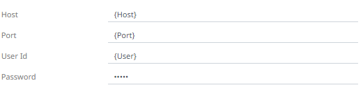

2. Click on a data source. The Data Source Settings pane is displayed.
3. Parameterize the entries in the pane.
For example:
