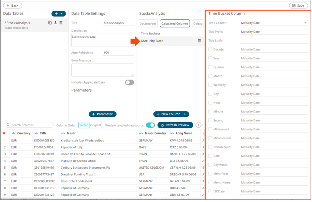

1. On the Data Sources pane, click Calculated Columns.
The Calculated Columns pane displays.
2. Click New Column > Time Bucket.
The Date/Time column (e.g., Maturity Date) that will be used for the time bucketing is displayed under the Calculated Columns pane and the Time Bucket Column pane also displays.
3. Enter the Title Prefix.
4. Enter the Title Suffix.

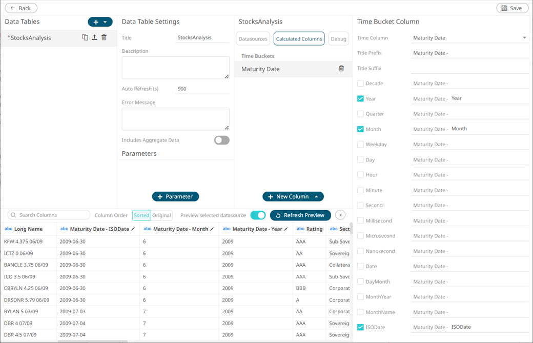

5. Select the required time buckets.
6. Click
. The new time bucketing columns are
added and displayed in the Data Preview.

Once selected the new time bucket columns will appear in the data table schema listing.

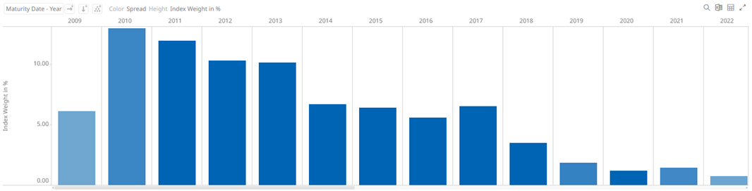

By creating the Year Time Part, a Bar graph of Maturity Year can be displayed:

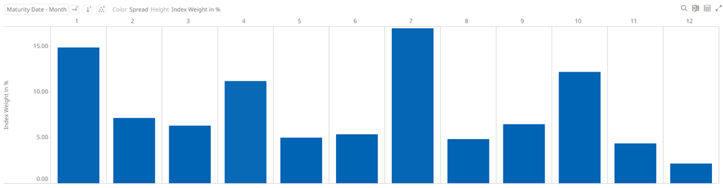

Similarly using the Month Time Part, a Bar graph of cumulative issuance by Month can be displayed:

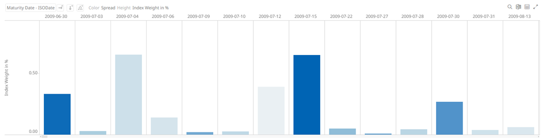

Using the ISODate Time Part, a Bar graph of cumulative issuance by ISO Date can be displayed.
