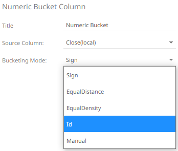

2. Click New Column > Numeric Bucket.
The numeric bucket instance is displayed on the Data Sources Settings with Numeric Bucket as the default title, also the Numeric Bucket Column pane displays.
You may opt to modify the numeric identity bucket's Title.
3. Select Id in the Bucketing Mode drop-down list box.

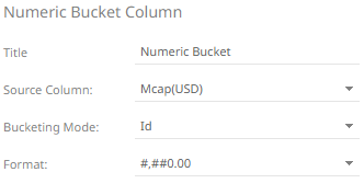

4. Select the numeric Source Column and Format.
5.     Click
. The new numeric identify bucket column
	 is added and displayed in the Data Preview.

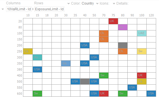

These new identity columns can then be used as categories in the breakdown, and as categorical filters:
