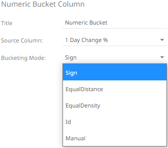

1. On the Data Sources pane, click Calculated Columns.
The Calculated Columns pane displays.
2. Click New Column > Numeric Bucket.
The numeric bucket instance is displayed on the Data Sources Settings with Numeric Bucket as the default title, also the Numeric Bucket Column pane displays.
You may opt to modify the numeric sign bucket's Title.
3. Select the numeric Source Column.
4. Select Sign in the Bucketing Mode drop-down list box.
5. Click

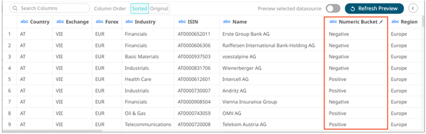

. The new numeric sign bucket column
is added and displayed in the Data Preview.
