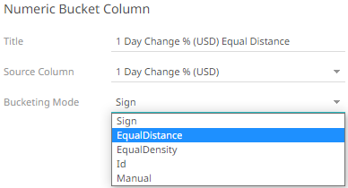

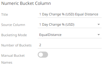

3. Select the numeric Source Column.
4. Select Equal Distance in the Bucketing Mode drop-down list box.

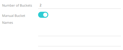

5. Enter the Number of Buckets. This value can be parameterized.
6. Tap the Manual Bucket slider to turn it on.
The Names text box are enabled. For this example, 2 text boxes are available based on the specified Number of Buckets in step 5.
7. Enter the bucket Names.

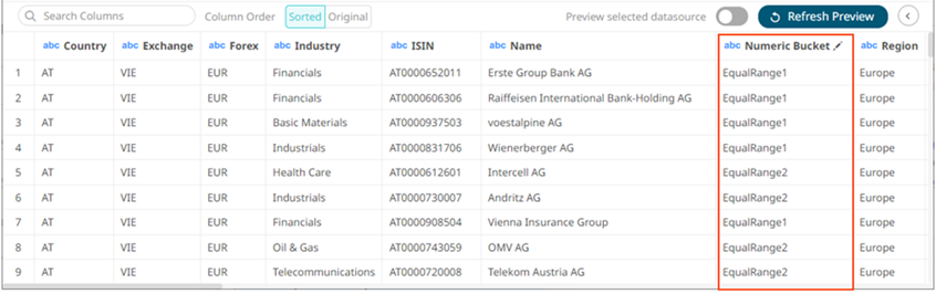

. The new numeric equal distance bucket
	 column is added and displayed in the Data Preview.

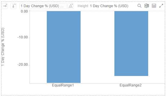

This new user defined column can be used in a visualizations breakdown to display data samples.
