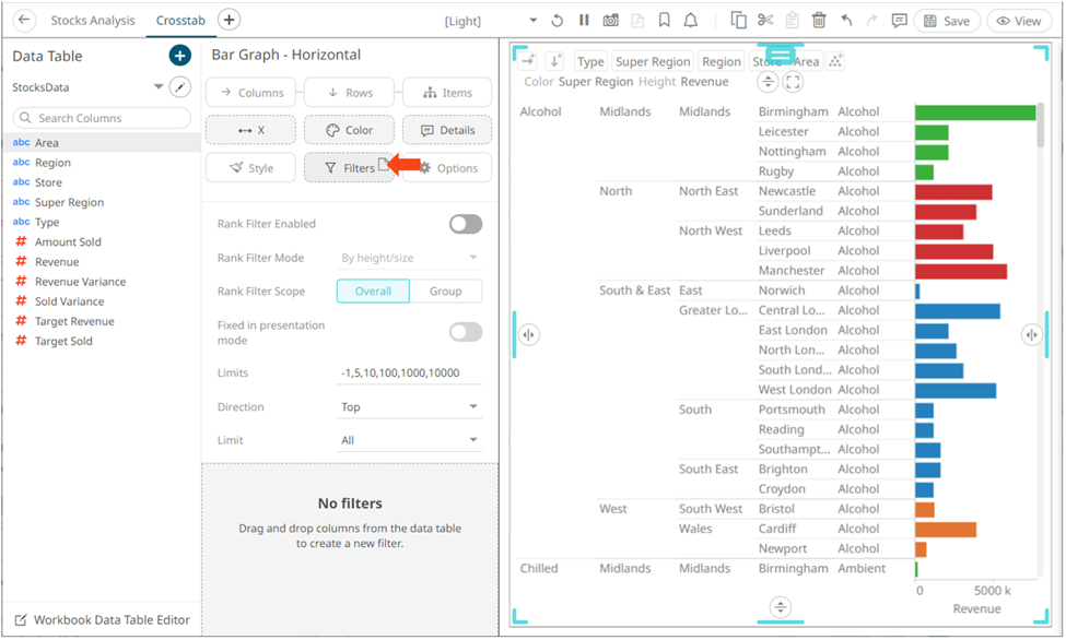

1. Click on a visualization to display its Properties pane.

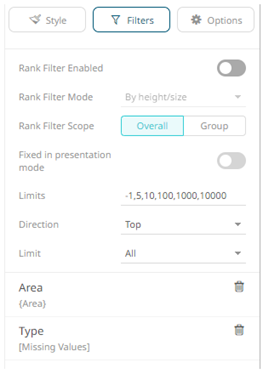

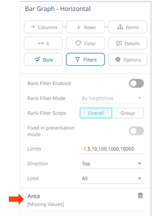

2. To add to the filter, drag text columns from the Data Table pane to the Filter drop area.
3. The column is added and the Visualization Settings pane changes to display the Filter properties.
Initially, there are no values added for the filter column.

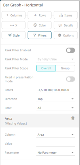

4. Click on the filter column. The pane changes again.
5. Enter the Value.
    NOTE  |
    You can add more than one value for a column. For example:    |
The visualization is updated based on the filter column values.
