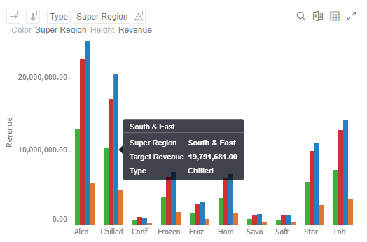

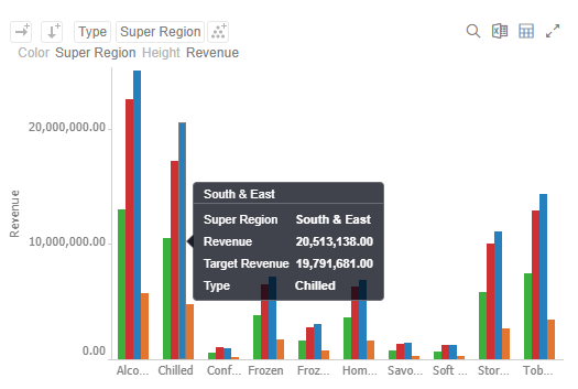

Details Variable Configuration
The Details variable controls the information that appears on the pop-up when hovering over a specific item within a visualization. It also controls the information available for export from the visualization.

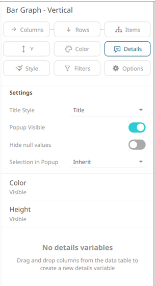

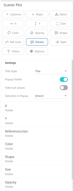

1. Click on the Details button of a visualization. The Details Settings pane displays along with the available variables of the visualization.
Sample 1: Scatter Plot visualization has HeightX, HeightY, Size, Color,Opacity, Shape, and Reference Lines variables.

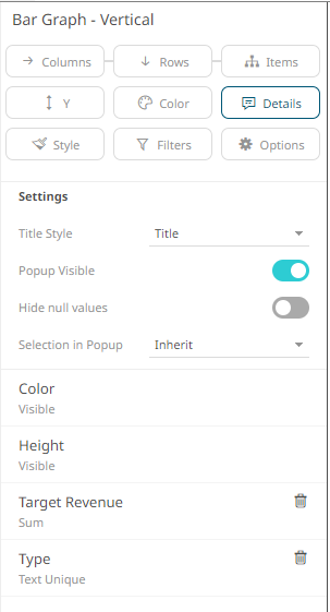

Sample 2: Bar Graph – Vertical visualization has HeightY and Color variables.

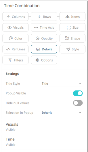

Sample 3: Time Combination visualization has Visuals and Time variables.
2. Select the Title Style: Title, Visible Path, or Full Path.
3. By default, Popup Visible is enabled to display the Details pop-up. Tap the slider to turn it off.
4. Tap the Hide Null Values slider to turn it on.

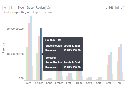

5. Select the Selection in Popup:
· On
The Details pop-up of the selection in the visualization is displayed.

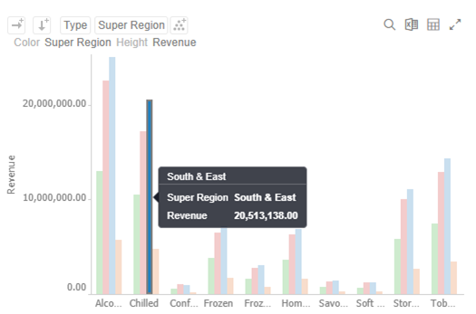

· Off
The selection in the Details pop-up is turned off.

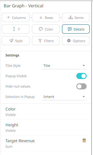

6.     You can also drag and drop numeric columns from the Data
	 Table pane to the Details
  button or
	 on the Details pane. .
The column is added under the Details pane.

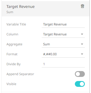

7. Click on the column to display the configuration pane.
8. Enter the label of the Details variable in the Variable Title field.
You can parameterize the variable title to support dynamic schema in the dashboards.
9. You can opt to change the column to the be used from the Column drop-down list.
10. Specify an aggregation method in the Aggregate field.
The default is Sum.

11. The Format field lets you specify the format that numbers will be displayed in. Panopticon uses the same formatting rules as Excel.
12. Select the Divide By value to divide a number:
· 1
· 1000 (by a thousand)
· 10000
· 1000000 (by a million)
· 1000000000 (by a billion)

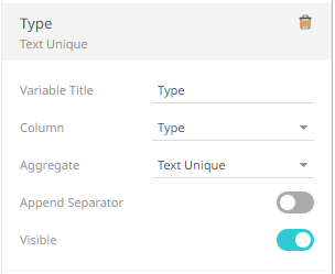

13.   You can also drag and drop text columns from the Data
 button or
14. Click on the column to display the configuration pane.
15. Enter the label of the Details variable in the Variable Title field.
16. You can also change the column to the be used from the Column drop-down list.
17. Select the text aggregation method from the Aggregate field: Count Distinct, Text Unique (default), or Text Concat Distinct.
18. The Format field lets you specify the format that the text will be displayed in. Panopticon uses the same formatting rules as Excel.

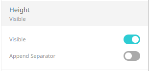

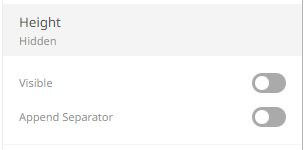

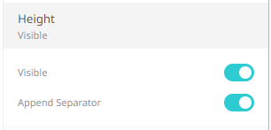

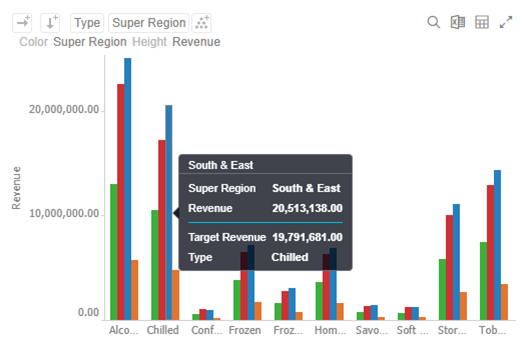

19. By default, all of the variables are set to be Visible on the Details pop-up.
For example, when the Height variable column is Revenue and set to Visible, the value of Revenue is displayed in the Details pop-up.
Tap the Visible slider to turn it off so the variable detail will not be displayed.
20. Tap the Append Separator slider to display the separator of the values.

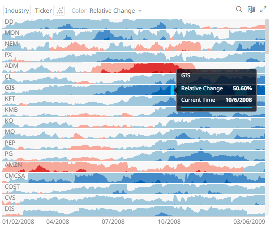

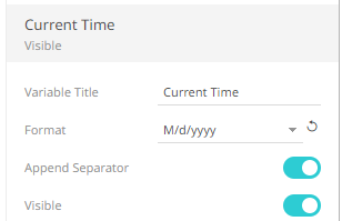

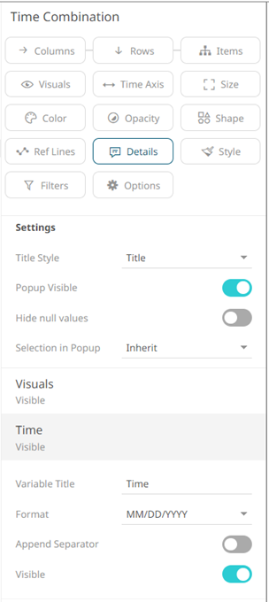

21. For time series visualizations, you can set the current time period that will be displayed on the Details pop-up. Otherwise, skip to step 22.
Set the Variable Title and the Format.
For example:
