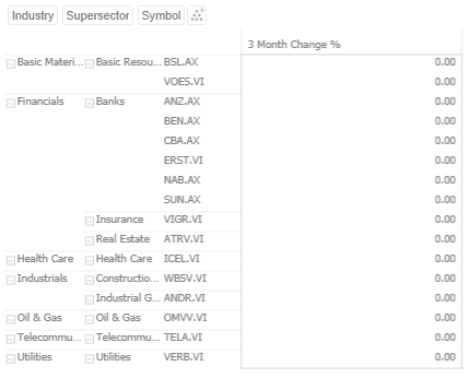

Changing the aggregate to Level and the format to #,##0.00 will produce this table since the Visible Depth is set until Symbol:
Sample 2

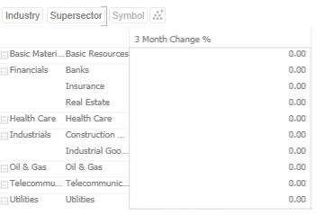

Clicking on Supersector will make the Symbol breakdown column invisible:
Sample 3

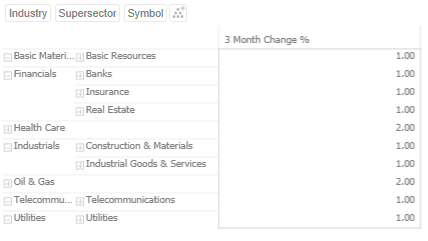

Collapsing columns in the table can also change the Level values:
Sample 4

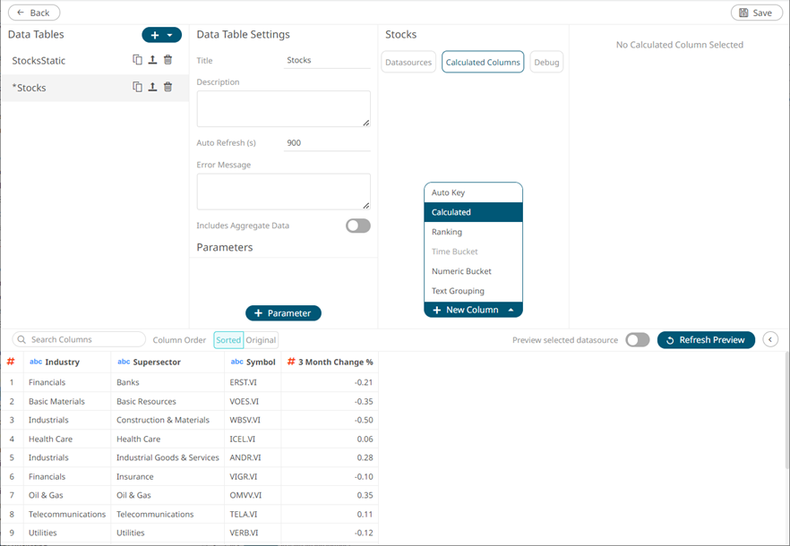

1. On the Data Table Editor layout page, click Calculated Columns and select Calculated.

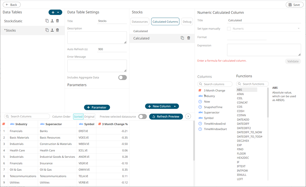

The Numeric Calculated Column pane displays.
2. Build the expression with the Level aggregate.
For example: 12.0 + [3 Month Change %:level]

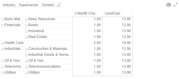

Collapsing columns in the table (similar with Sample 3 above) will result to:
