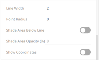

The numeric
line graph settings pane is displayed after clicking the Options
button.
Setting |
Description |
Line Width |
Specifies the width in pixels of the lines. |
Point Radius |
Specifies the radius of each point in pixels that the line passes through. |
Shade Area Below Line |
Defines that opacity shades are applied between the lines and the zero Y grid line. |
Shade Area Opacity (%) |
Specifies the opacity (transparency) of the shaded area, expressed in percent 0-100 of the opacity value currently set on the line. |
Show Coordinates |
Determines whether the graph coordinates (i.e., X-Y plots, or Date/Time-Y plots) on mouse over are displayed in the visualization. |

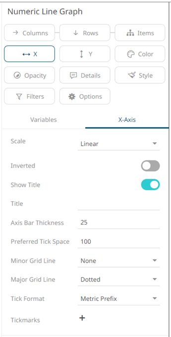

Other visualization-specific properties can be set by clicking on the X-Axis variable drop area and then selecting the X-Axis tab:

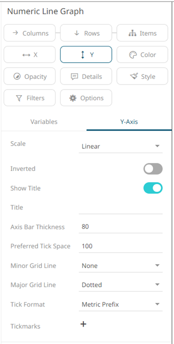

Or also, by clicking on the Y-Axis variable drop area and then selecting the Y-Axis tab:
