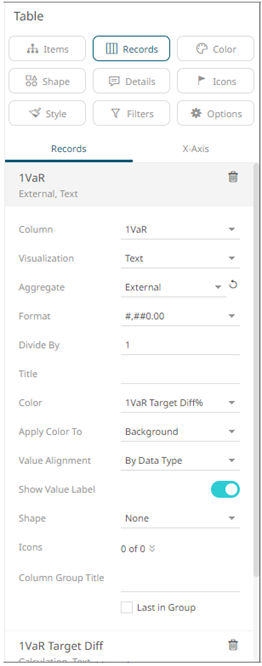

To retrieve external aggregates:
1. Retrieve your data set including both base data, plus aggregate data.
2. On the Data Table Settings pane, tap the Includes Aggregate Data slider to turn it on and then select the text column that defines the leaf.
3. Enter the Value to determine aggregate rows. The default being blank.
4.     Click the Save
  button.
    NOTE  |
    Within the visualization, the default aggregation method for all variables will be set to External.
