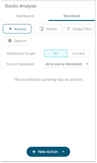

1.     On the Dashboard and Workbook Settings  pane, click the Workbook tab.
The Actions pane is displayed. Initially, there are no actions defined for the workbook and the selected Dashboard Scope is All.

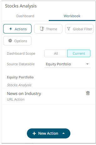

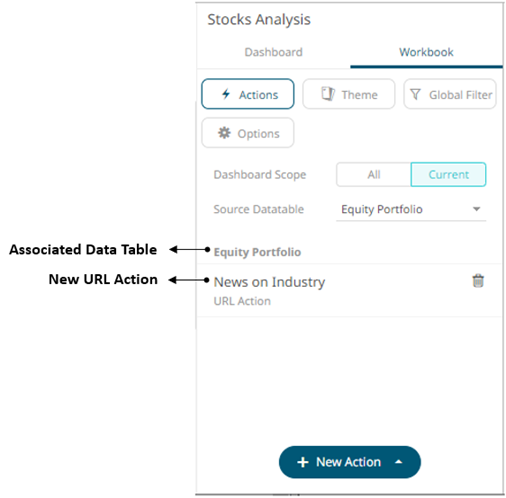

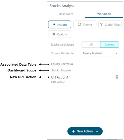

4.     Click the  button then select URL Action in the drop-down list.
The new URL action is added under the selected Dashboard Scope in the Actions list. For example, if Current is the selected dashboard scope and the source data table is Equity Portfolio, then it will be displayed as:

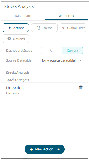

However, if no source data table is selected, then the first one in the Data Table pane (i.e., StocksAnalysis) is the default associated to the new URL action.

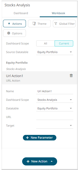

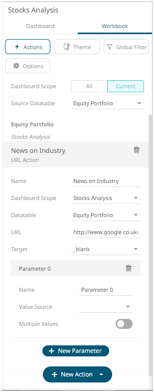

5.     Click the new URL action instance to expand and display the properties that you can define.
6.     Enter or select the following properties:
Setting
Name
The name of the URL action and then click .
Dashboard Scope
The dashboard where you will define the dashboard scope data parameters that will be passed to the target dashboard.
Can either be [All Dashboard] or the current dashboard.
Data Table
The source data table. This will eventually be displayed above the URL action instance.

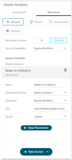

URL
The parameterized URL and then click .
The parameters are written within curly brackets, {ParameterName}.
For actions allowing multiple value input, you can optionally specify a value separator within the curly brackets where you put the parameter name. The syntax is as follows:
{ParameterName:Separator}
For example: {Company:+}
Default separator is semicolon. Specifying for example a plus sign allows you to do multi search term searches on Google, for example.
At execution, the parameter will be replaced with real field values associated with the selected visualization node.
The easiest way to create parameterized URLs is to open an example web page and copy the URL. As an example, Yahoo Finance Key Statistics for Microsoft has the following web address:
http://finance.yahoo.com/q/ks?s=MSFT
If a parameter called Ticker has been set up in the data table, you can generate the URL by removing MSFT and replacing it with {Ticker}:
http://finance.yahoo.com/q/ks?s={Ticker}
Target
The target area of the page where the output URL will be displayed. Available options are:
7.     Click the  button to add parameters to the output URL. A new parameter instance is added.
8.     Click on the parameter instance to expand and define its properties.

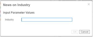

Input Validation and Error Message
Both fields are enabled when an interactive parameter (i.e., $Interactive)  is selected in the Value Source drop-down list.
Typically, interactive parameters are used to pass data back to data repositories or external systems.
When an action is executed which require an interactive parameter, an associated dialog box will be displayed.
For example:
Add a custom Input Validation. This can be any regular expression (e.g., “A-Z{3}”)
The parameter will not be updated unless it passes the validation. Enter an Error Message to help in defining a better input to match the regular expression (e.g., “Please use a 3-letter code.”)
