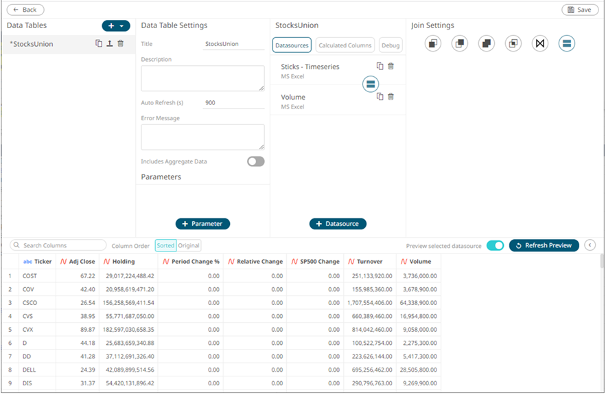

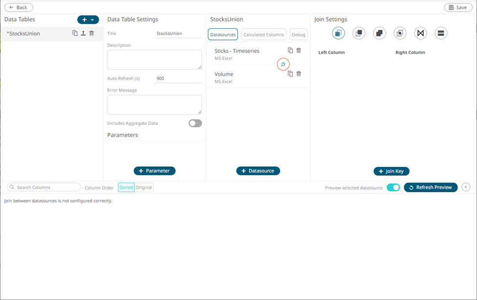

1.     To join the data sources, click the
	 Join
 button.
The Join Settings pane displays.

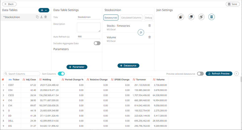

2.     Select Union All
 then click
The result of the union all is displayed in the Data Source Preview.
