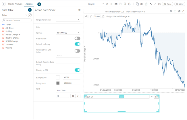

1. After double-clicking or drawing a rectangle
on the dashboard canvas, click on the Select Part pane
then click the Action Date Picker
icon.
The Action Date Picker pane is displayed, and the Action Date Picker part is added on the dashboard canvas with the current date and the Set button to the right.
2. Select the Target Parameter that will be updated by the action date picker.
2. 3.Enter the Title of the action date picker button.
3. Select the Date/Time Format.

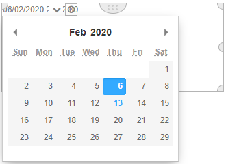

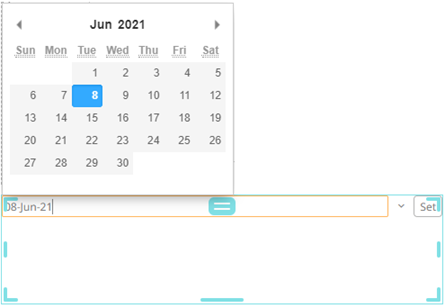

Clicking on the Date/Time box displays the current month.
The text of the date can be directly entered, or alternatively it can be clicked on, to bring up a date picker in the Web client.

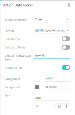

· now-7D will set the date picker to 7 days ago. This is the same as specifying
-7D
For example:
The date will be now-7D by default.
For example, now is January 15, it will go back 7 days (January 8) and then the date will be recalculated along with the Date/Time format.

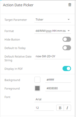

Complex expressions can also be entered to recalculate the relative date. These expressions are evaluated from the left to right pattern. The now term can also be used as a pointer to the currently evaluated value of the relative time expression.
For example, if you enter now-5M-2D+3Y in the Action Date Picker Settings pane:
The date will be now-5M-2D+3Y by default.

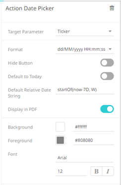

In the expression, you can also use startOf and endOf functions. Both functions take the same arguments, a relative time string, and a unit.
For example, if you enter startOf(now, D):
The date will display the start of the current day:
Lastly, you can define a complex expression with the functions. For example, if you enter startOf(now-7D, W):
The date will display the start of the previous week:
