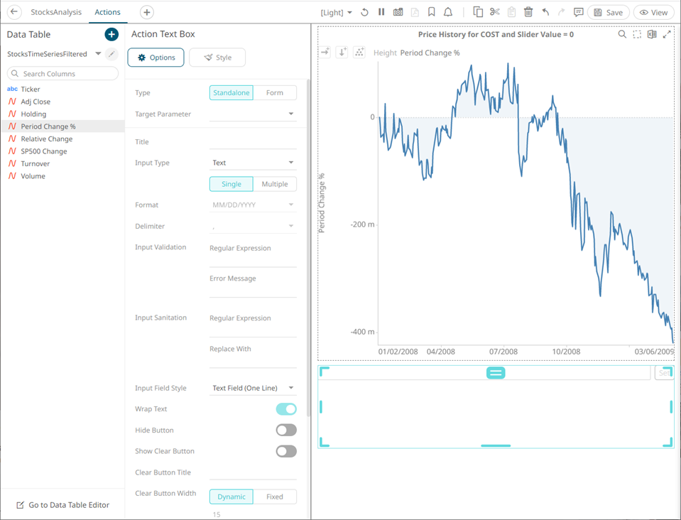

1. After double-clicking or drawing a rectangle
on the dashboard canvas, click
on the Select Part
pane then click the Action Text Box
icon.
The Action Text Box pane is displayed, and the Action Text Box part is added on the dashboard canvas.

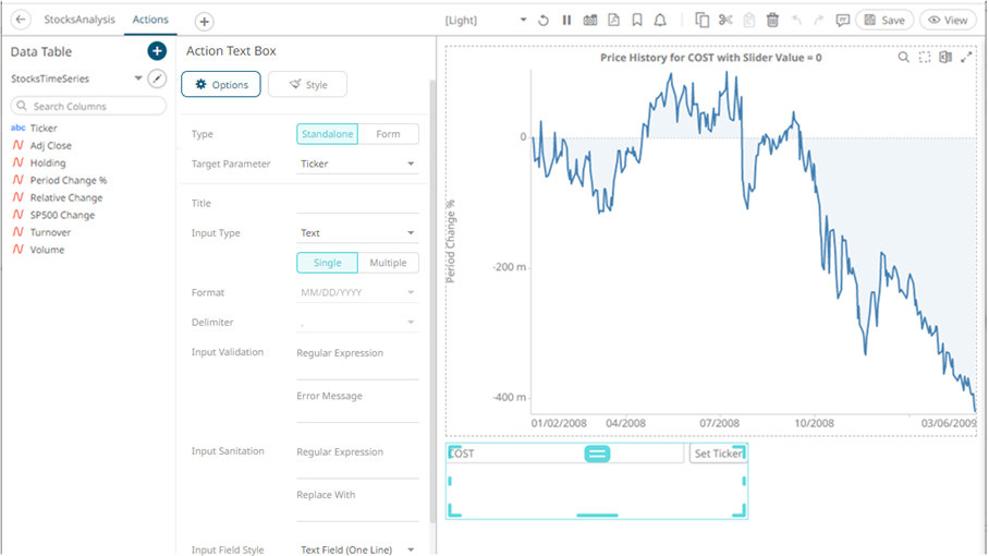

2. The action text box can be configured to either be a Standalone or a Form component.

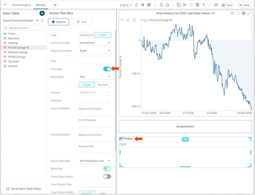

When set to Form, the action text box can be connected to any form controller on the same dashboard. The parameters that the action part can set depends on how the form is configured.
NOTE |
An action form part must be defined first to associate the action text box as a component. Refer to Adding an Action Form more information. |
A line connects the component to the associated form. By default, the Show Title slider is turned on and the title is displayed to describe what parameter the text box is setting (e.g., Set Ticker). Tap to slider to turn it off.
If the action text box should not be connected to a form, it can be set to Standalone instead. Select the Target Parameter that will be updated by this action part.
3. Enter the Title of the text box.
If set to the Standalone type and the Title is blank, the button will be Set <Target Parameter>.

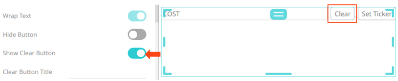

11. Tap the Show Clear Button slider to display a button that will clear the text box when clicked.
12. Enter the Clear Button Title, if required.

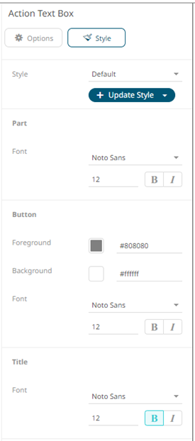

17. To set the style of the Action Text
Box, click Style
The page updates to display the Style pane.
18. Set the Font type, size, style (Bold and/or Italic) of the part, button, and title.
The title’s font is set to Bold by default.
19. Click the Foreground or Background box to display the Color dialog and set the button’s color or enter the Hex color code.
20. Click Update Style
and select any of the following
options:

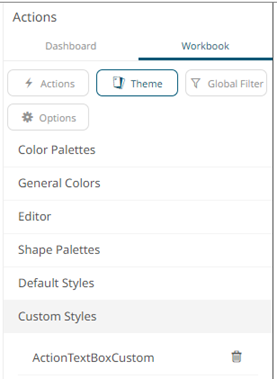

· Set current as default – Save the changes and set it as the default.
· Create custom style – Save the changes and set it as a custom style.
The Style pane updates to display the Title control.
¨ Enter the custom style Title.
¨ If there are additional changes made, click Update Current Style in the Update Style drop-down.
The new custom style is added in the Workbook > Theme > Custom Styles list.
If published, the custom style configuration of the Action Text Box will be added to the Global custom styles list and can be applied to other parts.
