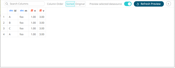

However, when there are two or more non-unique combinations of values in the columns that are not specified as Measure or Value columns, they may not be aggregated.

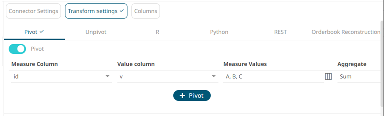

For the sample above, the Measure column is the one you want to pivot. In this case, you will pivot to create a unique Sum per v and measure.
The column named id will be used as the Measure (pivot) column, and value column (v) is the one you will aggregate.
Click the
	 Populate
	 Measure Values
	   button to populate the Measure Values box that you can
	 aggregate (i.e., A, B, C). The default Sum aggregation is applied.

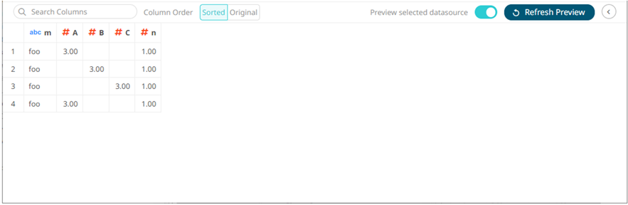

Clicking
 transforms
	 the data and is displayed on the Data Sources Preview.

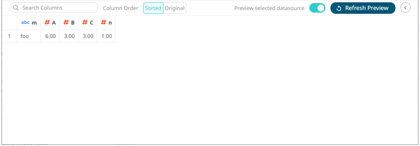

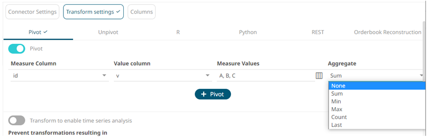

Note that the n column is not aggregated after pivoting. To fix this, set the Aggregate to None.
After clicking
, the expected pivot is achieved and there is
	 no aggregate applied to all of the columns.
