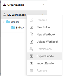

1. Right-click on a workbook or folder and select Export Bundle on the context menu.
Workbook Folder or Subfolder Context Menu |
Workbook Context Menu |

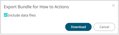

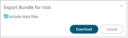

A notification message displays.
The Include Data Files box is checked by default. This means the associated workbook data files will be included in the download.
2. Click
. A copy of
the workbook or folder bundle is downloaded.
