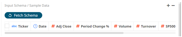

7. On the Input Schema/Sample Data section, the column names of the input data source are displayed.
In cases where there are no rows from the input data source and the Python script is not handling zero rows, you can add sample data to ensure transform is applied.
To add or manage the sample data, you can use the following icons:
