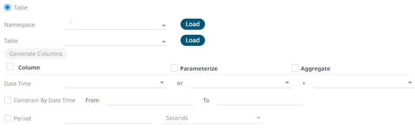

6. When Table is selected, the section below is enabled:
The Namespace drop-down is an editable combo box.
You can either:
·         click
 and select a namespace
	 from the list of all root level namespaces. By default, the selected
	 namespace will be root (backtick `).
· For nested namespaces, enter them in the Namespace box (e.g., panopticon.test) to get the tables that were created under these namespaces.
7.     On the Table field, click
 to
	 populate the drop-down list with tables and views. Select a table
	 or view.
8.     Click
. The columns of the selected table or view populates
	 the Output Column section.
9. Individual columns can be added by checking the corresponding Column box in the Output Column listing.
10. If the data returned is to be aggregated, then the Aggregate checkbox should be selected. For each selected column, the possible aggregation methods are listed including:
· Text Columns: Group By
· Date Columns: Count, Min, Max, Group By
· Numeric Columns: Sum, Count, Min, Max, Group By
In addition, the qSQL query is generated and displayed on the Query text box.
11. Check the Parameterize checkbox and match the parameter to the appropriate column. By default, they will be matched by name.
The appropriate qSQL query is updated on the Query text box.

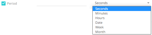

13. In kdb+, you can modify the query to regroup the aggregated data per time units (i.e., Seconds, Minutes, Hours, Date, Week, Month). Check the Period box, enter the time duration and click then select the time unit.
