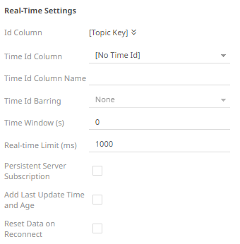

10. For this section:
Refer to Define Real-Time Settings for more information.
