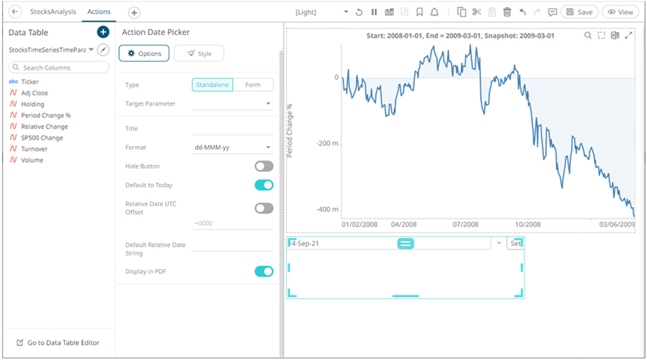

The Action Date Picker pane is displayed, and the Action Date Picker part is added on the dashboard canvas with the current date and the Set button to the right.

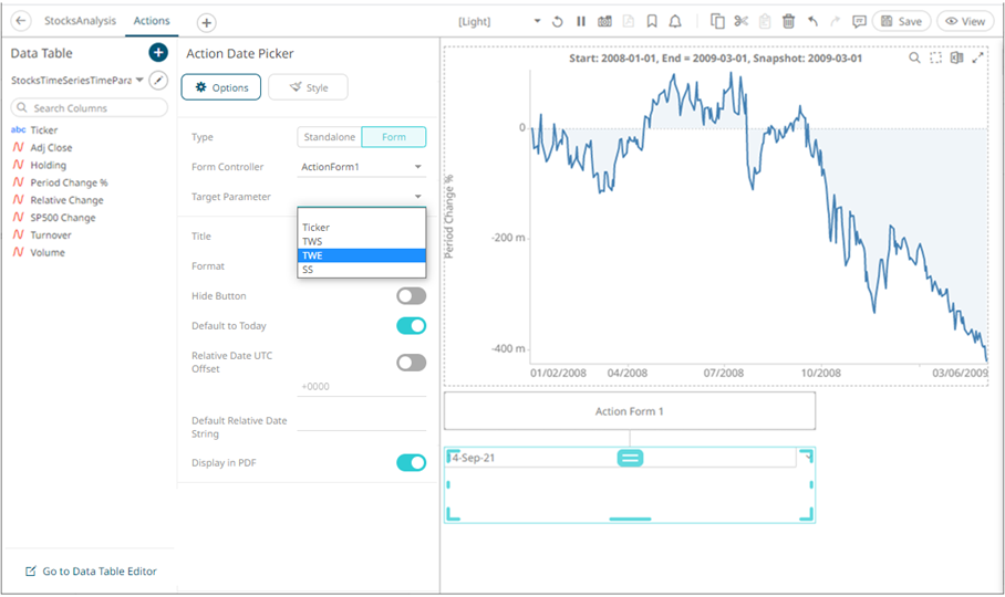

2. The action date picker can be configured to either be a Standalone or a Form component.
When set to Form, the action date picker can be connected to any form controller on the same dashboard. The parameters that the action part can set depends on how the form is configured.
NOTE |
An action form part must be defined first to associate the action date picker as a component. Refer to Adding an Action Form more information. |
A line connects the component to the associated form.

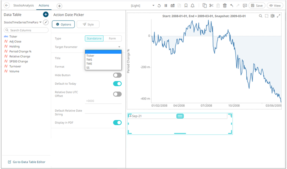

If the action date picker should not be connected to a form, it can be set to Standalone instead. Select the Target Parameter that will be updated by this action part.

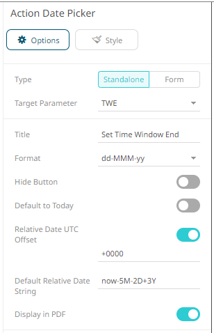

3. Enter the Title of the action date picker button.
If set to the Standalone type and the Title is blank, the button will be Set <Target Parameter>.

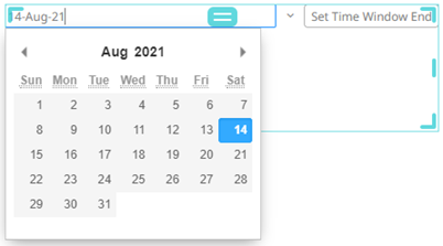

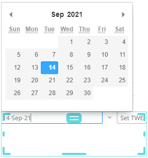

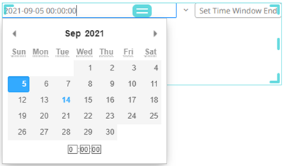

4. Select the Date/Time Format.
Clicking on the Date/Time box displays the date picker in calendar mode.
The text of the date can be directly entered, or alternatively it can be clicked on, to bring up a date picker in the Web client.
5. Tap the Hide Button slider to turn it on. This means the action control will update the parameter whenever the value of the date picker changes.
6. Tap the Default to Today slider to turn it on. This allows the action date picker to check the current value of the dashboard parameter. If it is set to null/empty, an action is executed to update the parameter and trigger the loading of the parameterized data with the current date.

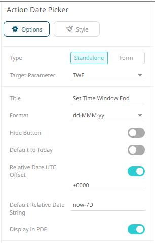

7. Tap the Relative Date UTC Offset slider to turn it on then enter the UTC Offset value (default is +0000).

8. Instead of turning the Default to
Today slider on, enter the Default Relative Date String
then click
This allows the relative date calculation (based on today’s date),
by parsing the input text string.

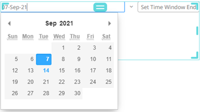

When these values are entered, the correct date should be selected, and then the data requests are executed based on this date.
The special now term can also be used, this represents the current Date/Time. For example:
· Using now will set the date picker to the current Date/Time
· now-7D will set the date picker to 7 days ago. This is the same as specifying
-7D
For example:
The date will be now-7D by default.
For example, now is September 14, it will go back 7 days (September 7) and then the date will be recalculated along with the Date/Time format.
In addition, you can use the SIGN UNIT NUMBER pattern to modify the relative date calculation.
For example, if you enter -1M, the recalculated relative date will be August 14.
Complex expressions can also be entered to recalculate the relative date. These expressions are evaluated from the left to right pattern. The now term can also be used as a pointer to the currently evaluated value of the relative time expression.
For example, if you enter now-5M-2D+3Y in the Action Date Picker Settings pane:
The date will be now-5M-2D+3Y by default.

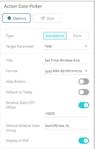

In the expression, you can also use startOf and endOf functions. Both functions take the same arguments, a relative time string, and a unit.

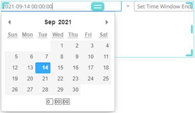

For example, if you enter startOf(now, D):
The date will display the start of the current day:

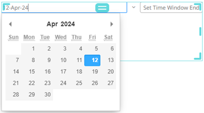

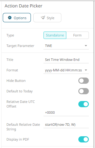

Lastly, you can define a complex expression with the functions. For example, if you enter startOf(now-7D, W):
The date will display the start of the previous week:

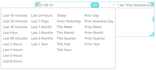

· The Default Relative Date String will be used if the dashboard parameter is null/empty. · The relative Date/Time string is case sensitive. · You can also opt to select from pre-populated date ranges: Refer to Selecting Relative Dates in Action Date Picker and Action Date Range Picker Controls for more information. |

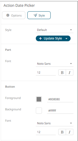

10. To set the style of the Action Date
Picker, click Style
The page updates to display the Style pane.
11. Set the Font type, size, style (Bold and/or Italic) of the part and button.
12. Click the Foreground or Background box to display the Color dialog and set the color or enter the Hex color code.
13. Click Update Style
and
select any of the following options:
· Set current as default – Save the changes and set it as the default.
· Create custom style – Save the changes and set it as a custom style.
The Style pane updates to display the Title control.
¨ Enter the custom style Title.

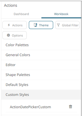

¨ If there are additional changes made, click Update Current Style in the Update Style drop-down.
The new custom style is added in the Workbook > Theme > Custom Styles list.
If published, the custom style configuration of the Action Date Picker will be added to the Global custom styles list and can be applied to other parts.
· Reset to default – Revert to the original default settings.
