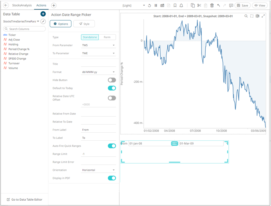

The Action Date Range Picker pane is displayed, and the Action Date Range Picker part is added on the dashboard canvas with the current date range (parameters From Date to To Date) and the Set button.
For this example, the following parameters are defined:
Parameter Name |
Type |
Default Value |
Ticker |
Text |
COST |
TWS |
Text |
2008-01-01 |
TWE |
Text |
2009-03-01 |
SS |
Text |
2009-03-01 |
These parameters are used on the Title of the Line graph (e.g., Start: {TWS: yyyy-MMM-dd HH:mm:ss}, End = {TWE: yyyy-MMM-dd HH:mm:ss}, Snapshot: {SS: yyyy-MMM-dd HH:mm:ss}).

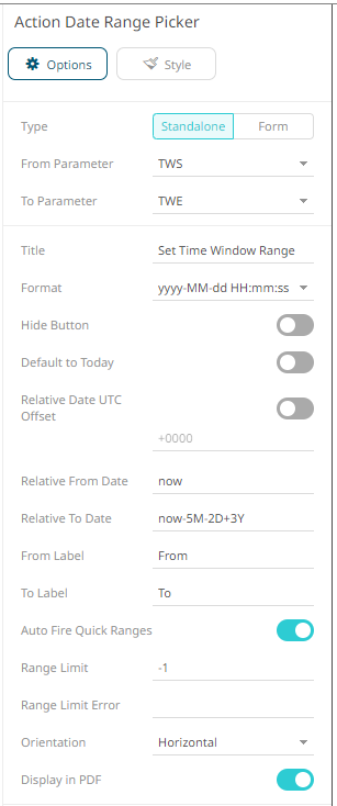

2. The action date range picker can be configured to either be a Standalone or a Form component.
When set to Form, the action date range picker can be connected to any form controller on the same dashboard. The parameters that the action part can set depends on how the form is configured.
NOTE |
An action form part must be defined first to associate the action date range picker as a component. Refer to Adding an Action Form more information. |
A line connects the component to the associated form.
If the action date picker should not be connected to a form, it can be set to Standalone instead. Select the parameters that will be used for the From Parameter and To Parameter dates range.

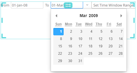

3. Enter the Title of the action date range picker button.

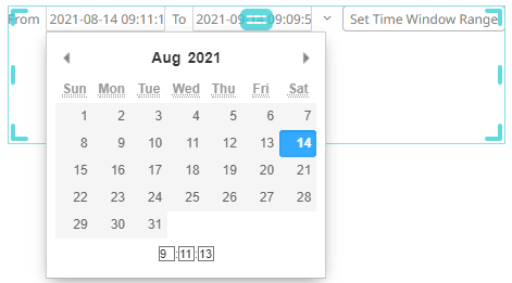

4. Select the Date/Time Format.
Clicking on the Date/Time box displays the date picker in calendar mode.
The text of the date can be directly entered, or alternatively it can be clicked on, to bring up a date picker in the Web client.

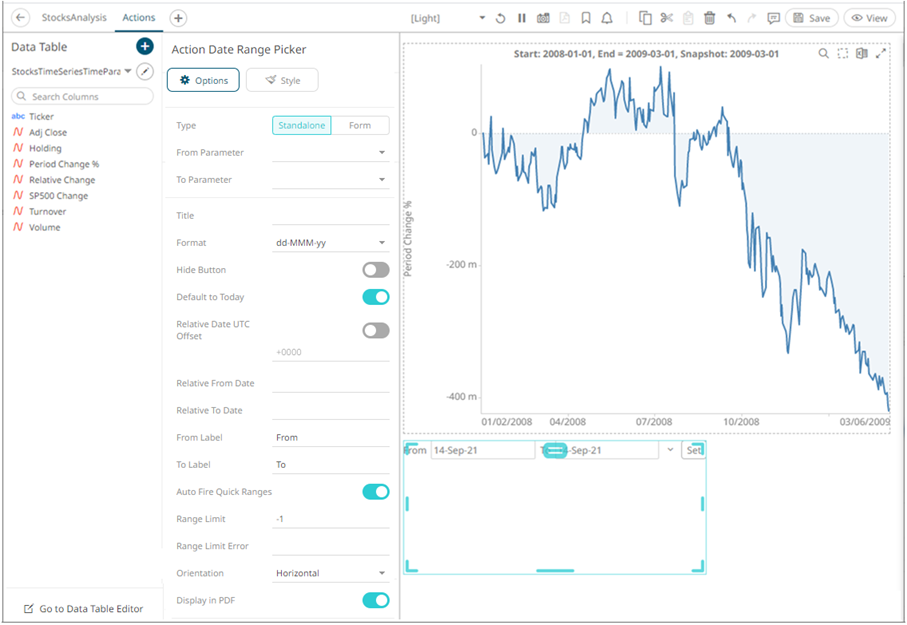

5. Tap the Hide Button slider to turn it on. This means the action control will update the parameter whenever the value of the data picker changes.
6. Tap the Default to Today slider to turn it on. This allows the action date range picker to check the current value of the dashboard parameter. If it is set to null/empty, an action is executed to update the parameter and trigger the loading of the parameterized data with the current date.
7. Tap the Relative Date UTC Offset slider to turn it on then enter the UTC Offset value (default is +0000).

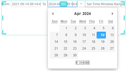

8. Instead of turning the Default to Today slider on, enter the following date range values:
· Relative From Date or the start Date/Time
· Relative To Dateor the end Date/Time
This allows the relative date calculation (based on today’s date), by parsing the input text string.

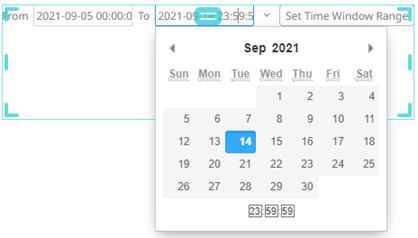

In the expression, you can also use startOf and endOf functions. Both functions take the same arguments, a relative time string, and a unit.
Lastly, you can define a complex expression with the functions. For example, if you enter startOf(now-7D, W) as the Relative From Date and endOf(now, D) as the Relative To Date:
The From date will display the start of the previous week and the To date will display the end of the current day:

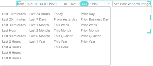

10. Tap the Auto Fire Quick Ranges
slider to turn it on. This automatically updates the date ranges as
you click in the drop-down in the Web client. Otherwise, you have
to select a date range first in the drop-down and then click
to update.

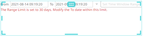

11. Set the Range Limit of the date by selecting the number of days. By default, the range limit is -1.
NOTE |
Selecting a shorter date range limit can help in having a faster response time. |
12. When a Range Limit has been set, the Range Limit Error box is enabled. It is mandatory to enter an error message to help in defining a better input to match the set limit.
For example: “The Range Limit is set to 30 days. Modify the To date within this limit.”

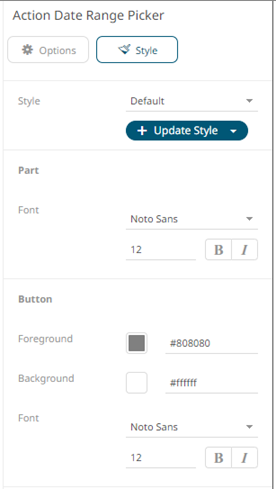

14. To set the style of the action date
range picker, click Style
The page updates to display the Style pane.
15. Set the Font type, size, style (Bold and/or Italic) of the part and button.
16. Click the Foreground or Background box to display the Color dialog and set the color or enter the Hex color code.
17. Click Update Style
and select any of the following options:
· Set current as default – Save the changes and set it as the default.
· Create custom style – Save the changes and set it as a custom style.
The Style pane updates to display the Title control.
¨ Enter the custom style Title.
¨ If there are additional changes made, click Update Current Style in the Update Style drop-down.

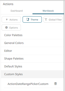

The new custom style is added in the Workbook > Theme > Custom Styles list.
If published, the custom style configuration of the action date range picker will be added to the Global custom styles list and can be applied to other parts.
· Reset to default – Revert to the original default settings.
