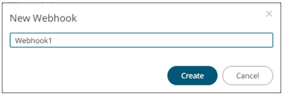

1. On the Webhooks tab, click on
a folder then
The New Webhook dialog displays.
2. Enter the name of the webhook then click
The new webhook is displayed on the Webhook page.

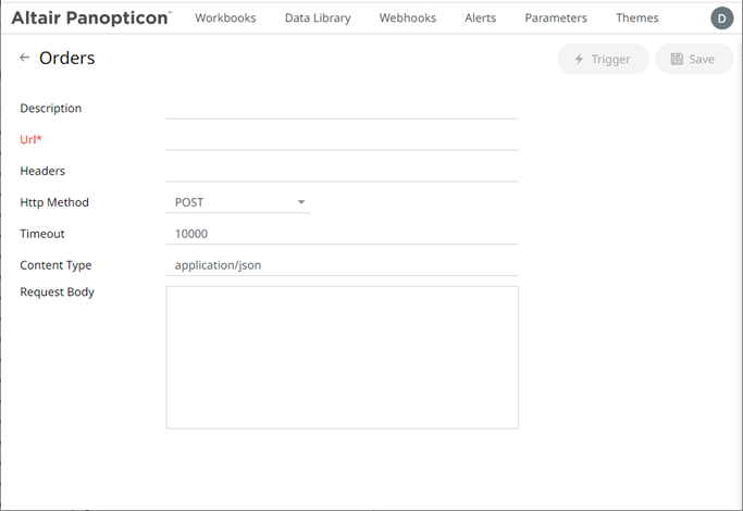

3. Enter or select the following webhook properties:
Property |
Description |
Description |
Description of the webhook. |
URL |
URL of the webhook. This property is required. |
Headers |
A comma separated list of name=value pairs representing HTTP headers. |
HTTP Method |
Select the appropriate HTTP method for the request from the following options:
· GET – retrieve data · POST – add new data · PUT – replace existing data · DELETE – remove existing data |
Timeout |
Timeout (in ms) for reading a response from the URL. |
Content Type |
The content type of the request body. Default is application/json. |
Request Body |
The request body to be supplied to the HTTP call. For example: { 'Alert title': '{_alert_title}', 'Alert dashboard URL': '{_alert_dashboard_url}', 'Alert description': '{_alert_description}', 'Alert reason': '{_alert_reason}', 'Triggering items': '{_alert_triggering_items}', 'Timestamp': '{_current_time}', 'Folder': '{_workbook_folder}', 'Workbook': '{_workbook_name}', 'Dashboard': '{_dashboard_name}' } |
NOTE |
URL, Headers, and Request Body fields can be parameterized (i.e., special server parameters, alert parameters, and global parameters). |
