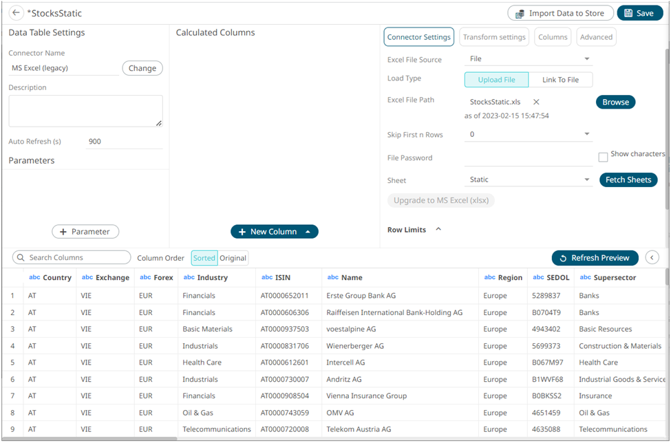

Steps:
1. Select or create the data table you want to import to data store.
2. Click

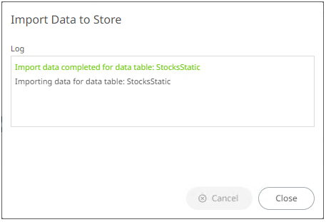

The notification dialog displays that the data table has been imported to data store.
The
icon also changes to
