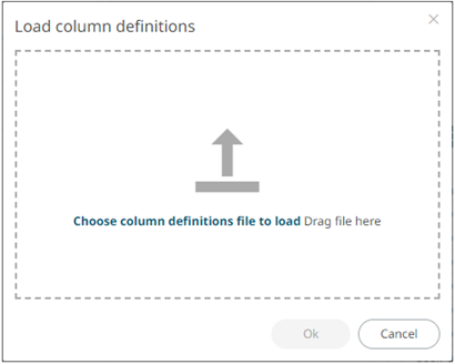

3.     Instead of generating columns done in
	 step 8, click
to load column definitions
	 (.exs) file.
The Load Column Definitions dialog displays.
3.1. To load column definitions, you can either:
¨ drag it from your desktop and drop in the dialog, or

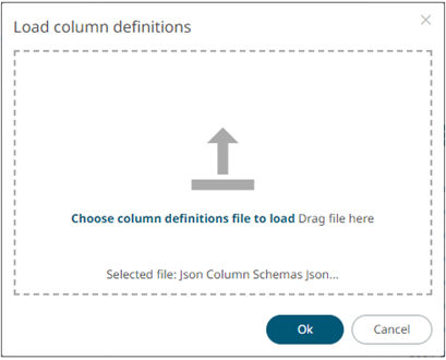

¨ click Choose Column Definitions File to Load and select one in the Open dialog that displays.
The name of the column definitions is displayed on the loaded column definitions area.

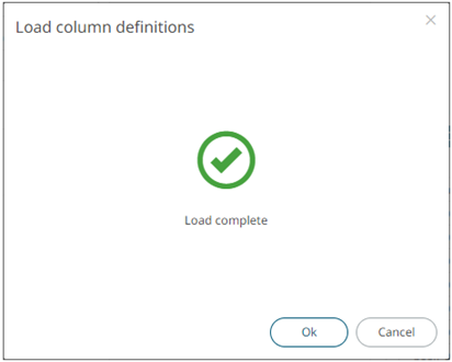

3.2.    Click
A notification displays when the file is loaded.
This populates the list of columns from the .exs file.
