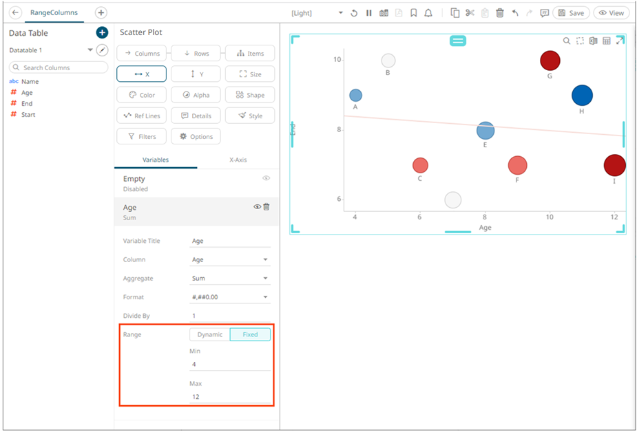

On the visualization, when the Age column is dragged to the X variable, the Min and Max values are applied.

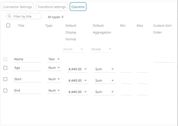

1. On the Data Sources panel, click a data source to display its settings.
2. Click Columns. The Columns pane displays the list of available columns in the data source.

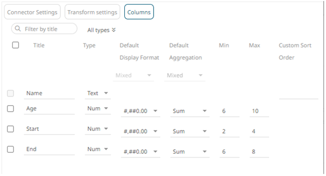

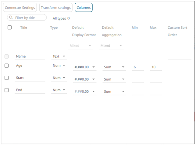

3. To set the fixed range for a single numeric column, enter the Min and Max values.
To set the fixed range for several numeric columns, check their corresponding boxes and enter their Min and Max values.
For example:
    Column  |
    Min  |
    Max  |
    Age  |
    6  |
    10  |
    Start  |
    2  |
    4  |
    End  |
    6  |
    8  |

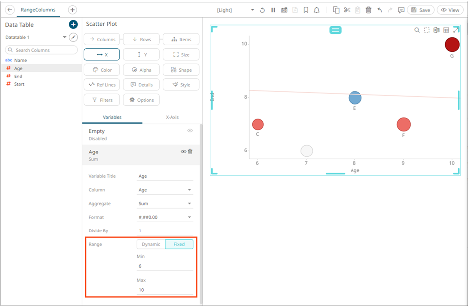

4.     Click the Save
  button.
When
	 saved, the
  notification displays.
On the visualization, when the Age column is dragged to the X variable, the set Min and Max values are applied.
