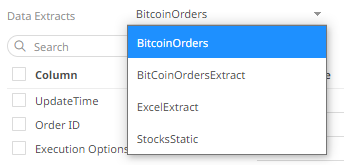

1. Select Streams Simulator - Extract from the Connectors panel. The Streams Simulator – Extract Settings panel displays the first data extract in the drop-down list (e.g., BitcoinOrders).
The list of columns is displayed, with the data type found from inspecting the first ‘n’ rows of the file. This also populates the Id Column with the set of columns, of arbitrary type, that can be concatenated to form a unique row identifier.
    NOTE  |
    To populate the list of columns, the data extract of a connector must be complete after refreshing the data.  |
You can also filter the list of columns by entering a text in the Search box.
2. You can opt to select another data extract to display its list of columns.

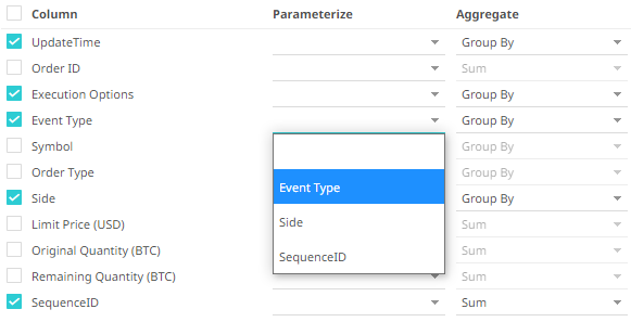

3. If the data returned is to be aggregated, then check their Column box. For each selected column, the possible aggregation methods are listed including:
· Text Columns: Group By
· Date/Time Columns: Group By
· Numeric Columns: Sum, Count, Min, Max, Mean
Select the Aggregate method in the drop-down list.
4. If you wish to parameterize a specific column, match the parameter to the appropriate column. By default, they will be matched on name.

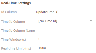

8. For this section:
Refer to Define Real-Time Settings for more information.
