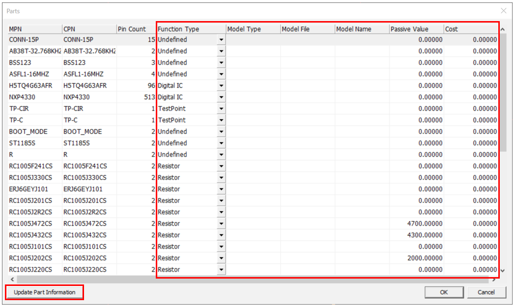

View part property assignment.
From the menu bar, select Properties > Parts.
- The Parts dialog shows the status of the properties assignment to the parts which are included in the current PCB system to analyze. Function Type and Cost of each component are editable from this dialog.
- The Parts dialog shows also the Model Type, Model File and Model Name if there is part assigning with SPICE or S-Parameter model.
- If you click the Update Part Information, you can load and apply the currently configured part information.

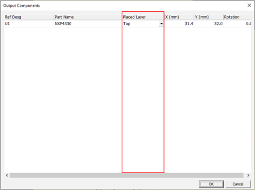

Select Properties > Output Components to view receiver component information.
You can edit the Placed Layer from this dialog.
Figure 2. -

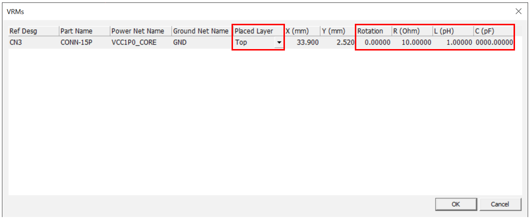

Select Properties > VRMs to view power source component information.
You can edit the Placed Layer and also RLC values from this dialog.
Figure 3. -

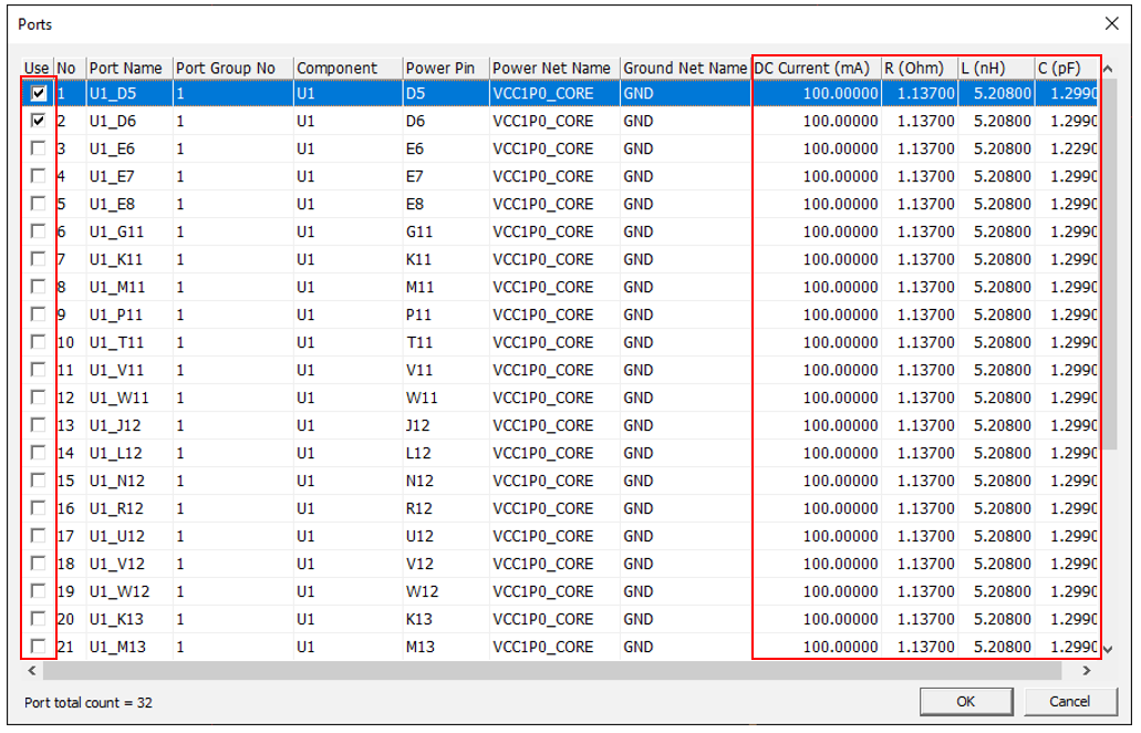

Select Properties > Ports to view power load component information.
You can :
- choose each port you want to use on this dialog
- edit the DC Current (mA) for DC IR-Drop analysis from this dialog
- edit the R (ohm), L(nH) and C(pF) value for each ports
Figure 4. -
