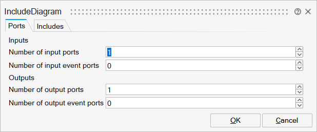

nin | Number of input ports | Defines the number of input ports of the block. This must match the number of input port blocks inside the included diagram. | Number | |
nevin | Number of input event ports | Defines the number of activation input ports of the block. This must match the number of activation input port blocks inside the included diagram. | Number | |
nout | Number of output ports | Defines the number of output ports of the block. This must match the number of output port blocks inside the included diagram. | Number | |
nevout | Number of output event ports | Defines the number of output activation ports of the block. This must match the number of output activation port blocks inside the included diagram. | Number |

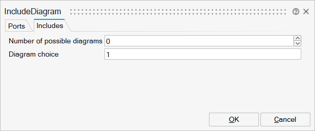

ndiagrams | Number of possible diagrams | More than one diagrams may be specified to be included. This parameters specifies the number of specified diagrams. | Number | |
choice | Diagram choice | It specifies which diagram to include if more than one diagram is specified. | Scalar | |
work | Workspace | |||
includes | Include Diagrams | Structure | ||
includes/path | Model path | This parameter can be: - an absolute or relative path to the external model containing the included diagram. - an empty string ('') to designate the current simulated model. This is the default behavior. - a '.' to designate the model that contains the IncludeDiagram block. | Cell of strings | |
includes/dpath | Diagram path | The diagram path within the external model. It is the path within the model to get a specific diagram, which is accessible with / | Cell of strings | |
includes/context | Context | An OML script used as external context to the included diagram. | Cell of strings |
