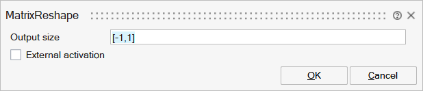

The MatrixReshape block changes the dimensions (but not the values) of a matrix or a vector as specified by the user in the "output size desired" parameter (as usual in Twin Activate, negative values may be used to specify unknown sizes.)
The input matrix can be either of type Double or type Complex and Column major indexing is assumed for matrices.
The output size (number of elements) must be equal to the input size.
outsize | Output size | size of the output matrix. For example [1,6]. Use of "-1" for the output size definition is permitted. | Vector of size 2 | |
