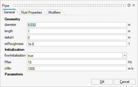

mo_diameter | diameter | inner diameter | Scalar | |
mo_length | length | pipe length | Scalar | |
mo_deltaH | deltaH | height difference between the ports B and A | Scalar | |
mo_relRoughness | relRoughness | inner surface relative roughness | Scalar | |
mo_flowInitialisation | flowInitialisation | Initialization of flow rate | Scalar | true |
mo_fMax | fMax | Highest frequency to be covered | Scalar | |
mo_cMin | cMin | Lowest speed of sound to be expected | Scalar | |

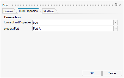

mo_forwardFluidProperties | forwardFluidProperties | Forward fluid properties between ports | Scalar | true |
mo_propertyPort | propertyPort | Property determining port if forwardFluidProperties = false | Structure | |
mo_propertyPort/choice1 | Port A | Number | 0 | |
mo_propertyPort/choice2 | Port B | Number | 0 |

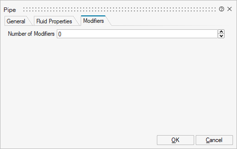

mo__modifiers/value | Value |
