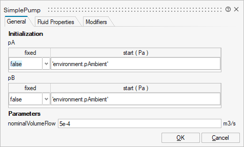

The component SimplePump is an ideal flow source. While the mass flow is constant, the resulting volume flows at both ports depend on the corresponding pressures and fluid temperatures. The parameter nominalVolumeFlow refers to the flow at Port A (suction side).
The component does not provide a model of the physical design of a pump but only copies its characteristic features. Thus, physical parameters (e. g. inertia moment or hydraulic-mechanical efficiency) are not parameterized.
mo_pA/start | start | Cell of scalars | ||
mo_pB | pB | pB | Structure | |
mo_pB/fixed | fixed | Cell of scalars | true | |
mo_pB/start | start | Cell of scalars | ||
mo_nominalVolumeFlow | nominalVolumeFlow | Nominal volume flow | Scalar | |

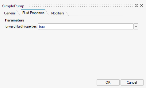

mo_forwardFluidProperties | forwardFluidProperties | Forward fluid properties between ports | Scalar | true |

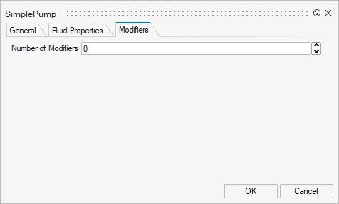

mo__modifiers/varname | Variable name | Cell of strings | 'volumeFlowA' | |
mo__modifiers/value | Value |
