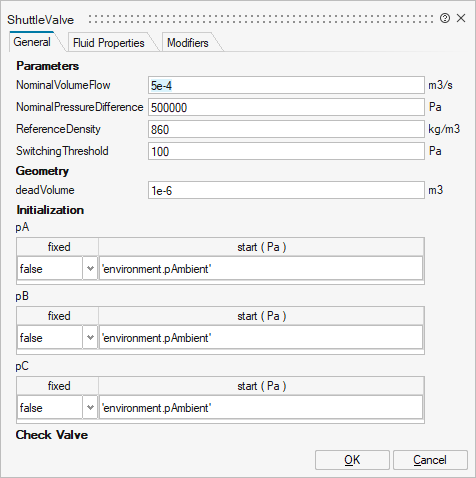

mo_NominalVolumeFlow | NominalVolumeFlow | Nominal volume flow | Scalar | |
mo_NominalPressureDifference | NominalPressureDifference | Nominal pressure difference | Scalar | |
mo_ReferenceDensity | ReferenceDensity | Reference density for volume flow and pressure difference | Scalar | |
mo_SwitchingThreshold | SwitchingThreshold | Pressure threshold to switch between ports | Scalar | |
mo_deadVolume | deadVolume | Dead volume at ports | Scalar | |
mo_pA/start | start | Cell of scalars | ||
mo_pB | pB | pB | Structure | |
mo_pB/fixed | fixed | Cell of scalars | true | |
mo_pB/start | start | Cell of scalars | ||
mo_pC | pC | pC | Structure | |
mo_pC/fixed | fixed | Cell of scalars | true | |
mo_pC/start | start | Cell of scalars | ||
mo_resistorType | resistorType | Type of the resistor | Structure | |
mo_resistorType/choice1 | Orifice | Number | 0 | |
mo_resistorType/choice2 | Throttle | Number | 0 |

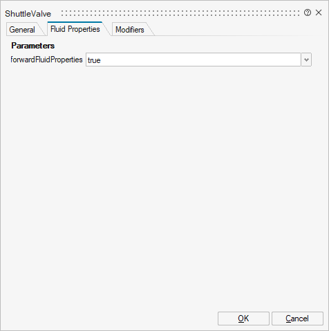

mo_forwardFluidProperties | forwardFluidProperties | Forward fluid properties between ports | Scalar | true |

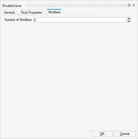

mo__modifiers/varname | Variable name | Cell of strings | 'connectA' | |
mo__modifiers/value | Value |
