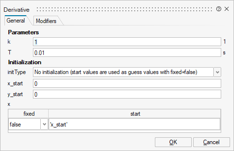

mo_k | k | Gains | Scalar | |
mo_T | T | Time constants (T>0 required; T=0 is ideal derivative block) | Scalar | |
mo_zeroGain | zeroGain | Scalar | true | |
mo_initType | initType | Type of initialization (1: no init, 2: steady state, 3: initial state, 4: initial output) | Structure | |
mo_initType/choice1 | No initialization (start values are used as guess values with fixed=false) | Number | 0 | |
mo_initType/choice2 | Steady state initialization (derivatives of states are zero) | Number | 0 | |
mo_initType/choice3 | Initialization with initial states | Number | 0 | |
mo_initType/choice4 | Initialization with initial outputs (and steady state of the states if possible) | Number | 0 | |
mo_x_start | x_start | Initial or guess value of state | Scalar | |
mo_y_start | y_start | Initial value of output (= state) | Scalar | |
mo_x | x | x | Structure | |
mo_x/fixed | fixed | Cell of scalars | true | |
mo_x/start | start | Cell of scalars |

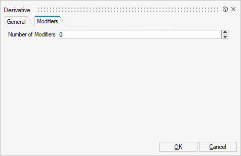

mo__modifiers/value | Value |
