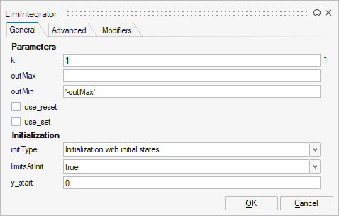

mo_k | k | Integrator gain | Scalar | |
mo_outMax | outMax | Upper limit of output | Scalar | |
mo_outMin | outMin | Lower limit of output | Scalar | |
mo_use_reset | use_reset | =true, if reset port enabled | Number | 0 |
mo_use_set | use_set | =true, if set port enabled and used as reinitialization value when reset | Number | 0 |
mo_initType | initType | Type of initialization (1: no init, 2: steady state, 3/4: initial output) | Structure | |
mo_initType/choice1 | No initialization (start values are used as guess values with fixed=false) | Number | 0 | |
mo_initType/choice2 | Steady state initialization (derivatives of states are zero) | Number | 0 | |
mo_initType/choice3 | Initialization with initial states | Number | 0 | |
mo_initType/choice4 | Initialization with initial outputs (and steady state of the states if possible) | Number | 0 | |
mo_limitsAtInit | limitsAtInit | = false, if limits are ignored during initialization (i.e., der(y)=k*u) | Scalar | true |
mo_y_start | y_start | Initial or guess value of output (must be in the limits outMin .. outMax) | Scalar |

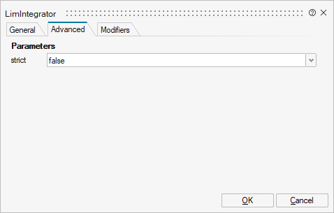

mo_strict | strict | = true, if strict limits with noEvent(..) | Scalar | true |

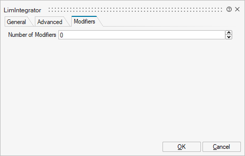

mo__modifiers/value | Value |
