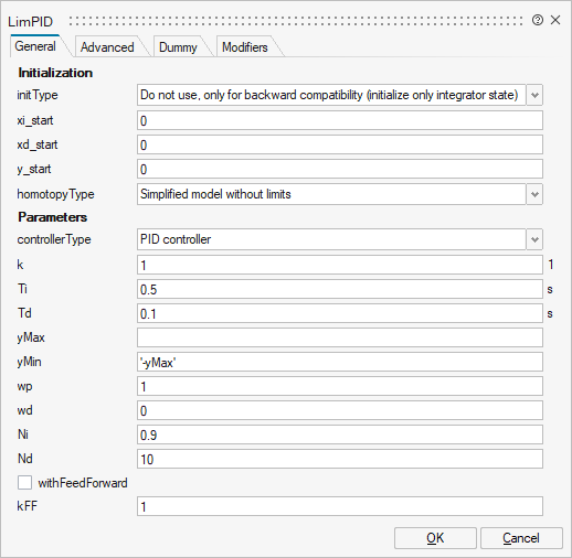

mo_initType | initType | Type of initialization (1: no init, 2: steady state, 3: initial state, 4: initial output) | Structure | |
mo_initType/choice1 | No initialization (start values are used as guess values with fixed=false) | Number | 0 | |
mo_initType/choice2 | Steady state initialization (derivatives of states are zero) | Number | 0 | |
mo_initType/choice3 | Initialization with initial states | Number | 0 | |
mo_initType/choice4 | Initialization with initial outputs (and steady state of the states if possible) | Number | 0 | |
mo_initType/choice5 | Do not use, only for backward compatibility (initialize only integrator state) | Number | 0 | |
mo_xi_start | xi_start | Initial or guess value for integrator output (= integrator state) | Scalar | |
mo_xd_start | xd_start | Initial or guess value for state of derivative block | Scalar | |
mo_y_start | y_start | Initial value of output | Scalar | |
mo_homotopyType | homotopyType | Simplified model for homotopy-based initialization | Structure | |
mo_homotopyType/choice1 | Homotopy is not used | Number | 0 | |
mo_homotopyType/choice2 | Simplified model without limits | Number | 0 | |
mo_homotopyType/choice3 | Simplified model fixed at upper limit | Number | 0 | |
mo_homotopyType/choice4 | Simplified model fixed at lower limit | Number | 0 | |
mo_controllerType | controllerType | Type of controller | Structure | |
mo_controllerType/choice1 | P controller | Number | 0 | |
mo_controllerType/choice2 | PI controller | Number | 0 | |
mo_controllerType/choice3 | PD controller | Number | 0 | |
mo_controllerType/choice4 | PID controller | Number | 0 | |
mo_k | k | Gain of controller | Scalar | |
mo_Ti | Ti | Time constant of Integrator block | Scalar | |
mo_Td | Td | Time constant of Derivative block | Scalar | |
mo_yMax | yMax | Upper limit of output | Scalar | |
mo_yMin | yMin | Lower limit of output | Scalar | |
mo_wp | wp | Set-point weight for Proportional block (0..1) | Scalar | |
mo_wd | wd | Set-point weight for Derivative block (0..1) | Scalar | |
mo_Ni | Ni | Ni*Ti is time constant of anti-windup compensation | Scalar | |
mo_Nd | Nd | The higher Nd, the more ideal the derivative block | Scalar | |
mo_withFeedForward | withFeedForward | Use feed-forward input? | Number | 0 |
mo_kFF | kFF | Gain of feed-forward input | Scalar | |
mo_with_I | with_I | Scalar | true | |
mo_with_D | with_D | Scalar | true |

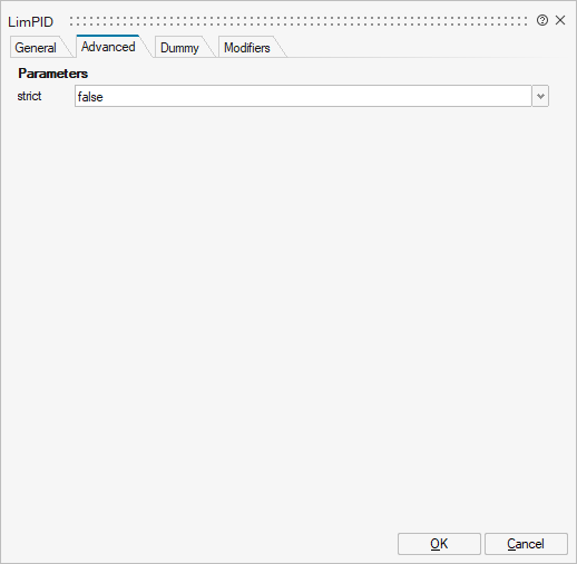

mo_strict | strict | = true, if strict limits with noEvent(..) | Scalar | true |

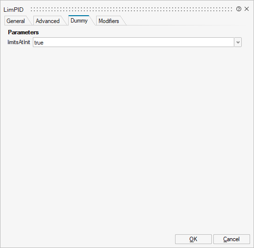

mo_limitsAtInit | limitsAtInit | Has no longer an effect and is only kept for backwards compatibility (the implementation uses now the homotopy operator) | Scalar | true |
