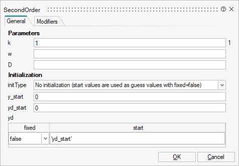

mo_k | k | Gain | Scalar | |
mo_w | w | Angular frequency | Scalar | |
mo_D | D | Damping | Scalar | |
mo_initType | initType | Type of initialization (1: no init, 2: steady state, 3/4: initial output) | Structure | |
mo_initType/choice1 | No initialization (start values are used as guess values with fixed=false) | Number | 0 | |
mo_initType/choice2 | Steady state initialization (derivatives of states are zero) | Number | 0 | |
mo_initType/choice3 | Initialization with initial states | Number | 0 | |
mo_initType/choice4 | Initialization with initial outputs (and steady state of the states if possible) | Number | 0 | |
mo_y_start | y_start | Initial or guess value of output (= state) | Scalar | |
mo_yd_start | yd_start | Initial or guess value of derivative of output (= state) | Scalar | |
mo_yd | yd | yd | Structure | |
mo_yd/fixed | fixed | Cell of scalars | true | |
mo_yd/start | start | Cell of scalars |

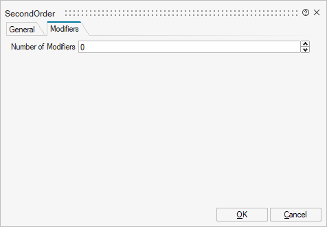

mo__modifiers/value | Value |
