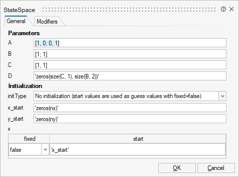

The State Space block defines the relationbetween the input u and the outputy in state space form:
der(x) = A * x + B * u y = C * x + D * u
The input is a vector of length nu, the output is a vectorof length ny and nx is the number of states. Accordingly
A has the dimension: A(nx,nx), B has the dimension: B(nx,nu), C has the dimension: C(ny,nx), D has the dimension: D(ny,nu)
Example:
parameter: A = [0.12, 2;3, 1.5] parameter: B = [2, 7;3, 1] parameter: C = [0.1, 2] parameter: D = zeros(ny,nu)results in the following equations: [der(x[1])] [0.12 2.00] [x[1]] [2.0 7.0] [u[1]] [ ] = [ ]*[ ] + [ ]*[ ] [der(x[2])] [3.00 1.50] [x[2]] [0.1 2.0] [u[2]] [x[1]] [u[1]] y[1] = [0.1 2.0] * [ ] + [0 0] * [ ] [x[2]] [u[2]]
mo_A | A | Matrix A of state space model (e.g., A=[1, 0; 0, 1]) | Matrix | |
mo_B | B | Matrix B of state space model (e.g., B=[1; 1]) | Matrix | |
mo_C | C | Matrix C of state space model (e.g., C=[1, 1]) | Matrix | |
mo_D | D | Matrix D of state space model | Matrix | |
mo_nin | nin | Number of inputs | Scalar | |
mo_nout | nout | Number of outputs | Scalar | |
mo_nx | nx | number of states | Scalar | |
mo_ny | ny | number of outputs | Scalar | |
mo_initType | initType | Type of initialization (1: no init, 2: steady state, 3: initial state, 4: initial output) | Structure | |
mo_initType/choice1 | No initialization (start values are used as guess values with fixed=false) | Number | 0 | |
mo_initType/choice2 | Steady state initialization (derivatives of states are zero) | Number | 0 | |
mo_initType/choice3 | Initialization with initial states | Number | 0 | |
mo_initType/choice4 | Initialization with initial outputs (and steady state of the states if possible) | Number | 0 | |
mo_x_start | x_start | Initial or guess values of states | Vector | |
mo_y_start | y_start | Initial values of outputs (remaining states are in steady state if possible) | Vector | |
mo_x | x | x | Structure | |
mo_x/fixed | fixed | Cell of vectors | true | |
mo_x/start | start | Cell of vectors |

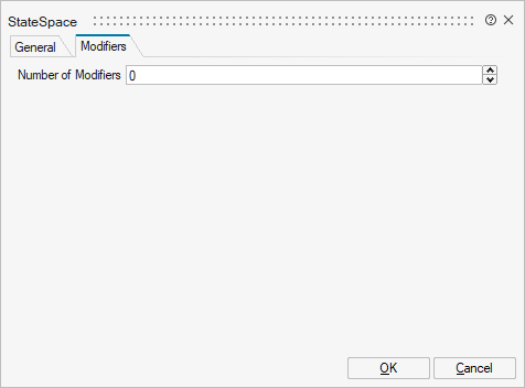

mo__modifiers/value | Value |
