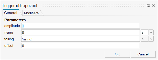

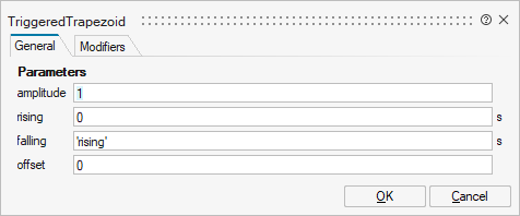

The block TriggeredTrapezoid has a Boolean input and a realoutput signal and requires the parameters amplitude,rising, falling and offset. Theoutput signal y represents a trapezoidal signal dependent on theinput signal u.
The behaviour is as follows: Assume the initial input to be false. In thiscase, the output will be offset. After a rising edge (i.e., the inputchanges from false to true), the output is rising during rising to thesum of offset and amplitude. In contrast, after a fallingedge (i.e., the input changes from true to false), the output is fallingduring falling to a value of offset.
Note, that the case of edges before expiration of rising or falling ishandled properly.
mo_amplitude | amplitude | Amplitude of trapezoid | Scalar | |
mo_rising | rising | Rising duration of trapezoid | Scalar | |
mo_falling | falling | Falling duration of trapezoid | Scalar | |
mo_offset | offset | Offset of output signal | Scalar |

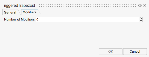

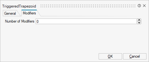

mo__modifiers/varname | Variable name | Cell of strings | 'endValue' | |
mo__modifiers/value | Value |
