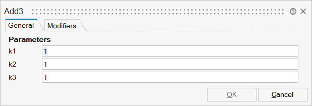

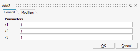

mo_k1 | k1 | Gain of input signal 1 | Scalar | |
mo_k2 | k2 | Gain of input signal 2 | Scalar | |
mo_k3 | k3 | Gain of input signal 3 | Scalar |

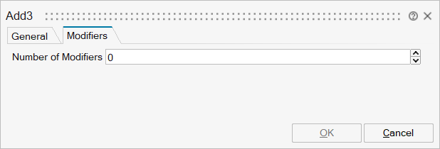

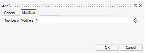

mo__modifiers/value | Value |
