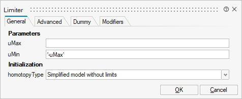

The parameter homotopyType in the Advanced tab specifies thesimplified behaviour if homotopy-based initialization is used:
NoHomotopy: the actual expression with limits is usedLinear: a linear behaviour y = u is assumed (default option)UpperLimit: it is assumed that the output is stuck at the upper limit u = uMaxLowerLimit: it is assumed that the output is stuck at the lower limit u = uMin
If it is known a priori in which region the input signal will be located, this option can helpa lot by removing one strong nonlinearity from the initialization problem.
mo_uMax | uMax | Upper limits of input signals | Scalar | |
mo_uMin | uMin | Lower limits of input signals | Scalar | |
mo_homotopyType | homotopyType | Simplified model for homotopy-based initialization | Structure | |
mo_homotopyType/choice1 | Homotopy is not used | Number | 0 | |
mo_homotopyType/choice2 | Simplified model without limits | Number | 0 | |
mo_homotopyType/choice3 | Simplified model fixed at upper limit | Number | 0 | |
mo_homotopyType/choice4 | Simplified model fixed at lower limit | Number | 0 |

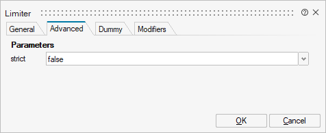

mo_strict | strict | = true, if strict limits with noEvent(..) | Scalar | true |

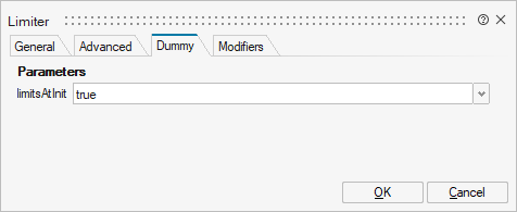

mo_limitsAtInit | limitsAtInit | Has no longer an effect and is only kept for backwards compatibility (the implementation uses now the homotopy operator) | Scalar | true |

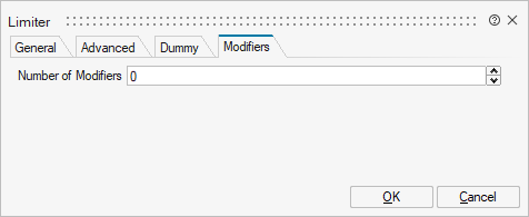

mo__modifiers/varname | Variable name | Cell of strings | 'simplifiedExpr' | |
mo__modifiers/value | Value |
