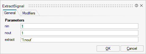

mo_nin | nin | Number of inputs | Scalar | |
mo_nout | nout | Number of outputs | Scalar | |
mo_extract | extract | Extracting vector | Vector |

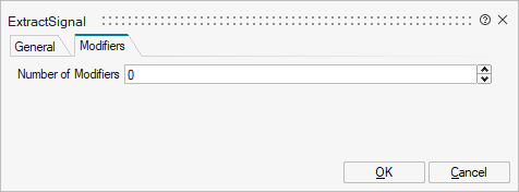

mo__modifiers/value | Value |
