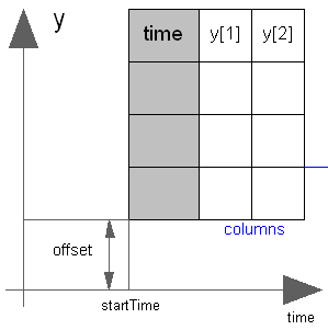

This block generates an output signal y[:] by constant,linear or cubic Hermite spline interpolationin a table. The time points and function values are stored in a matrixtable[i,j], where the first column table[:,1] contains thetime points and the other columns contain the data to be interpolated.
Via parameter columns it can be defined which columns of thetable are interpolated. If, e.g., columns={2,4}, it is assumed that2 output signals are present and that the first output is computedby interpolation of column 2 and the second output is computedby interpolation of column 4 of the table matrix.The table interpolation has the following properties:

- Via parameters shiftTime and offset the curve defined by the table can be shifted both in time and in the ordinate value. The time instants stored in the table are therefore relative to shiftTime.
- If time < startTime, no interpolation is performed and the offset is used as ordinate value for all outputs.

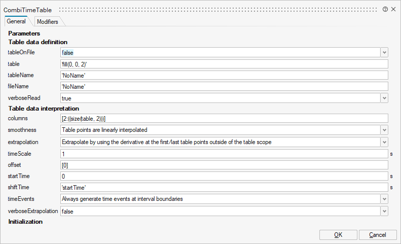

mo_nout | nout | Number of outputs | Scalar | |
mo_t_min | t_min | Minimum abscissa value defined in table | Scalar | |
mo_t_max | t_max | Maximum abscissa value defined in table | Scalar | |
mo_t_minScaled | t_minScaled | Minimum (scaled) abscissa value defined in table | Scalar | |
mo_t_maxScaled | t_maxScaled | Maximum (scaled) abscissa value defined in table | Scalar | |
mo_p_offset | p_offset | Offsets of output signals | Vector | |
mo_tableID | tableID | External table object | Scalar | |
mo_tableOnFile | tableOnFile | = true, if table is defined on file or in function usertab | Scalar | true |
mo_table | table | Table matrix (time = first column; e.g., table=[0, 0; 1, 1; 2, 4]) | Matrix | |
mo_tableName | tableName | Table name on file or in function usertab (see docu) | String | |
mo_fileName | fileName | File where matrix is stored | String | |
mo_verboseRead | verboseRead | = true, if info message that file is loading is to be printed | Scalar | true |
mo_columns | columns | Columns of table to be interpolated | Vector | |
mo_smoothness | smoothness | Smoothness of table interpolation | Structure | |
mo_smoothness/choice1 | Table points are linearly interpolated | Number | 0 | |
mo_smoothness/choice2 | Table points are interpolated (by Akima splines) such that the first derivative is continuous | Number | 0 | |
mo_smoothness/choice3 | Table points are not interpolated, but the value from the previous abscissa point is returned | Number | 0 | |
mo_smoothness/choice4 | Table points are interpolated (by Fritsch-Butland splines) such that the monotonicity is preserved and the first derivative is continuous | Number | 0 | |
mo_smoothness/choice5 | Table points are interpolated (by Steffen splines) such that the monotonicity is preserved and the first derivative is continuous | Number | 0 | |
mo_extrapolation | extrapolation | Extrapolation of data outside the definition range | Structure | |
mo_extrapolation/choice1 | Hold the first/last table point outside of the table scope | Number | 0 | |
mo_extrapolation/choice2 | Extrapolate by using the derivative at the first/last table points outside of the table scope | Number | 0 | |
mo_extrapolation/choice3 | Repeat the table scope periodically | Number | 0 | |
mo_extrapolation/choice4 | Extrapolation triggers an error | Number | 0 | |
mo_timeScale | timeScale | Time scale of first table column | Scalar | |
mo_offset | offset | Offsets of output signals | Vector | |
mo_startTime | startTime | Output = offset for time < startTime | Scalar | |
mo_shiftTime | shiftTime | Shift time of first table column | Scalar | |
mo_timeEvents | timeEvents | Time event handling of table interpolation | Structure | |
mo_timeEvents/choice1 | Always generate time events at interval boundaries | Number | 0 | |
mo_timeEvents/choice2 | Generate time events at discontinuities (defined by duplicated sample points) | Number | 0 | |
mo_timeEvents/choice3 | No time events at interval boundaries | Number | 0 | |
mo_verboseExtrapolation | verboseExtrapolation | = true, if warning messages are to be printed if time is outside the table definition range | Scalar | true |
mo_nextTimeEvent | nextTimeEvent | nextTimeEvent | Structure | |
mo_nextTimeEvent/fixed | fixed | Cell of scalars | true | |
mo_nextTimeEvent/start | start | Cell of scalars | ||
mo_nextTimeEventScaled | nextTimeEventScaled | nextTimeEventScaled | Structure | |
mo_nextTimeEventScaled/fixed | fixed | Cell of scalars | true | |
mo_nextTimeEventScaled/start | start | Cell of scalars |
mo__modifiers/varname | Variable name | Cell of strings | 'timeScaled' | |
mo__modifiers/value | Value |
