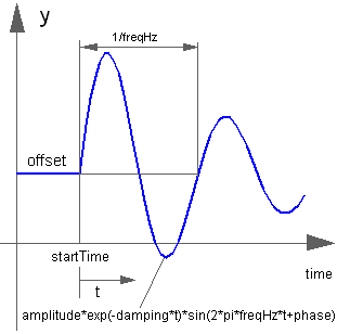

The Real output y is a sine signal with exponentially changing amplitude:

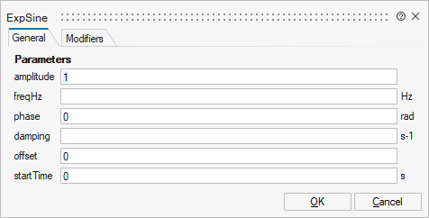

mo_amplitude | amplitude | Amplitude of sine wave | Scalar | |
mo_freqHz | freqHz | Frequency of sine wave | Scalar | |
mo_phase | phase | Phase of sine wave | Scalar | |
mo_damping | damping | Damping coefficient of sine wave | Scalar | |
mo_offset | offset | Offset of output signal y | Scalar | |
mo_startTime | startTime | Output y = offset for time < startTime | Scalar |
