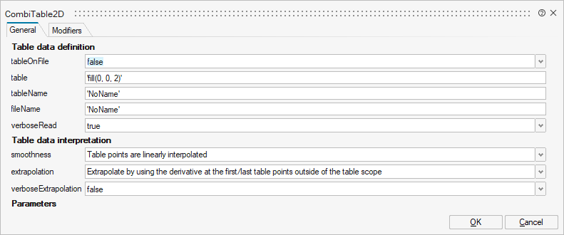

mo_tableOnFile | tableOnFile | = true, if table is defined on file or in function usertab | Scalar | true |
mo_table | table | Table matrix (grid u1 = first column, grid u2 = first row; e.g., table=[0, 0; 0, 1]) | Matrix | |
mo_tableName | tableName | Table name on file or in function usertab (see docu) | String | |
mo_fileName | fileName | File where matrix is stored | String | |
mo_verboseRead | verboseRead | = true, if info message that file is loading is to be printed | Scalar | true |
mo_smoothness | smoothness | Smoothness of table interpolation | Structure | |
mo_smoothness/choice1 | Table points are linearly interpolated | Number | 0 | |
mo_smoothness/choice2 | Table points are interpolated (by Akima splines) such that the first derivative is continuous | Number | 0 | |
mo_smoothness/choice3 | Table points are not interpolated, but the value from the previous abscissa point is returned | Number | 0 | |
mo_smoothness/choice4 | Table points are interpolated (by Fritsch-Butland splines) such that the monotonicity is preserved and the first derivative is continuous | Number | 0 | |
mo_smoothness/choice5 | Table points are interpolated (by Steffen splines) such that the monotonicity is preserved and the first derivative is continuous | Number | 0 | |
mo_extrapolation | extrapolation | Extrapolation of data outside the definition range | Structure | |
mo_extrapolation/choice1 | Hold the first/last table point outside of the table scope | Number | 0 | |
mo_extrapolation/choice2 | Extrapolate by using the derivative at the first/last table points outside of the table scope | Number | 0 | |
mo_extrapolation/choice3 | Repeat the table scope periodically | Number | 0 | |
mo_extrapolation/choice4 | Extrapolation triggers an error | Number | 0 | |
mo_verboseExtrapolation | verboseExtrapolation | = true, if warning messages are to be printed if table input is outside the definition range | Scalar | true |
